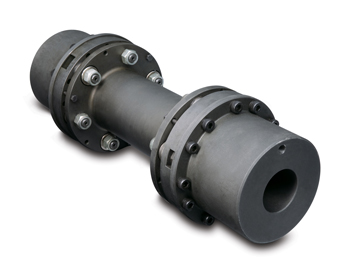

 Typical disc coupling specifically designed for process pump and general purpose
Typical disc coupling specifically designed for process pump and general purpose applications. This all-metal disc coupling requires no lubrication and incorporates a plug-in feature to allow installation and removal without disturbing the pump alignment. Photo supplied by TB Wood's.

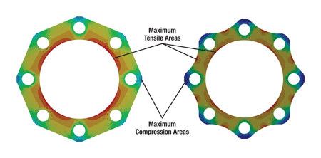

Scalloped and profile discs are "stress optimized" by removing low stressed areas of material (Figure 9). They are lighter and have lower stiffness; however, the edge stresses are greater, which requires a better edge surface finish to minimize stress concentrations where a failure could initiate.
 Torque stresses. Loading variations are dependent on application conditions.
Figure 9. Torque stresses. Loading variations are dependent on application conditions.
High stresses in the midpoint on the scallop design require surface finishes achievable only through costly EDM machining or by adding costly finishing operations. Stampings are not recommended for scalloped discs. Because of the relatively high cost of EDM processing, scalloped discs are best suited to custom/high speed applications, rather than in low-cost, general-purpose couplings.
