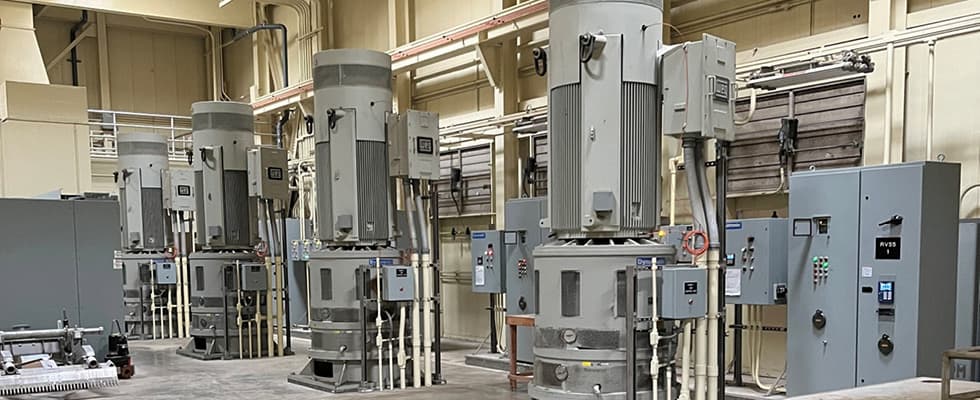

Four 450 hp 514 rpm vertical ECDs

87th Street Pumping Station
Beginning in 2015, the city of Kansas City, Missouri, needed to add variable speed drives and replace pumps in a large wastewater pumping station. The city elected to specify four 450 horsepower (hp) 514 revolutions per minute (rpm) vertical ECDs at the 87th Street Pump Station. Eddy current technology replaced constant speed motors and pumps whose only means of flow control had been throttled valves.
