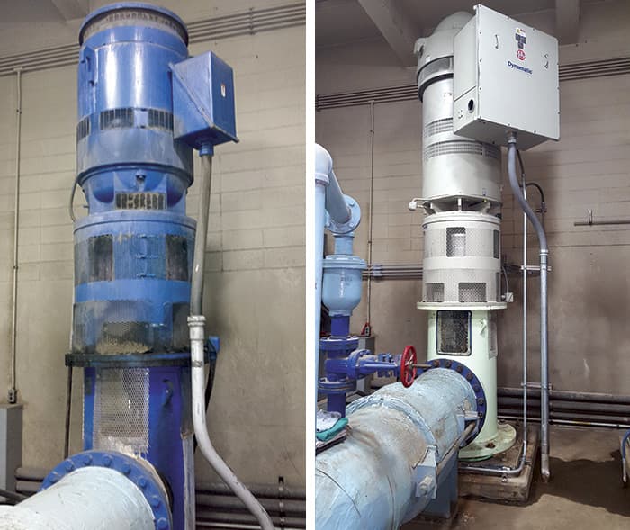

![Images 1 (left) and 2 (right). A water utility in southern Indiana recently replaced an aging 500-horsepower eddy current drive on a high service pump (Image 1) with a new unit of the same model (Image 2). It was still operational after more than 30 years of service.](/sites/default/files/0516/Image-2-3-TONED.jpg)
