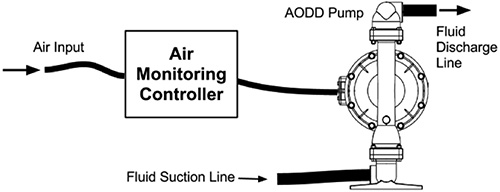

Figure 1. Air monitoring controllers monitor the pump through the air line without contacting the pumped fluid.

Air Monitoring Controllers
Another category of controllers that avoids the problems of level detection devices is air monitoring controllers. Air monitoring controllers work similarly to load-monitoring controllers on electric motors, turning the pump off when the air input indicates that the pump is running dry.
Some controllers in this category rely only on mechanical switches, while others use electronic controls. The mechanical controllers typically detect a change in pressure or flow to determine when a pump is running dry. Because a dry-running pump faces little to no resistance, it operates faster and uses more air than when transferring liquid.
While mechanical controllers have the benefit of operating without power, they can be unreliable when plant conditions change, such as the input or pump discharge pressure.
Air monitoring controllers with electronics can employ more sophisticated logic to compensate for changing environments, and also better detect when a pump is truly running dry.
Some of these solutions use pressure sensors to listen to the pump like a stethoscope to detect the individual stroke rate, which typically changes much more than the air input rate.
Ignoring short-term changes (false positives), restarting on timers and interfacing with PLCs are other  benefits.

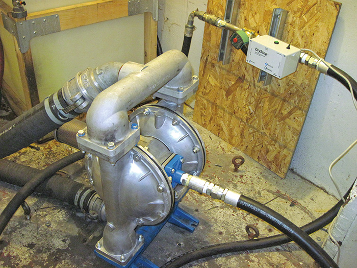

Image 1. AODD pump in a factory transfer application with an air monitoring controller.
