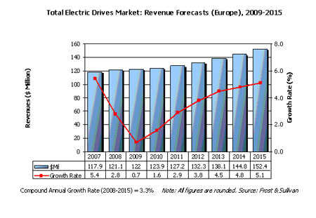

European Market Forecast
The following graph shows the forecast for the total electric drives market in Europe from 2009 to 2015. The base year is 2008.
Figure 1
Figure 1
The short-term market is expected to exhibit weak growth, but improvements in the global economy are anticipated to help lift growth back to more familiar territory by the end of the forecast period. Of the base year revenues, drives used for pumps accounted for approximately 64 percent of the total, with compressors and fans at 20 percent and 16 percent, respectively.
