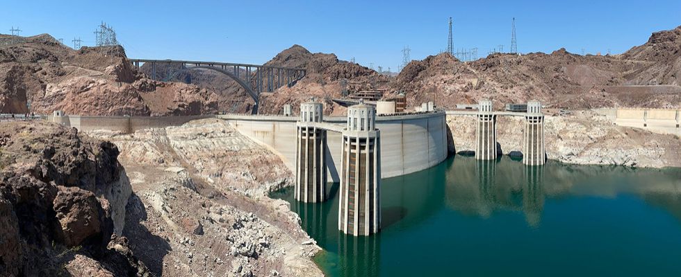

IMAGE 1: VFDs are commonly used in pumps associated with dams. (Photo credit: Roger Holzberg, pexels.com)
