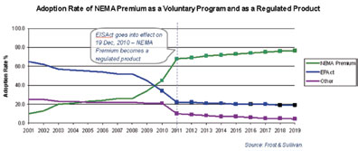

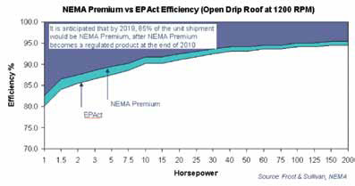

When selecting a new motor today, a buyer has two choices for electric motor efficiency: EPAct (Energy Policy Act of 1992) efficiency or NEMA (National Electrical Manufacturers Association) Premium efficiency, which has a higher efficiency requirement and costs 10 to 15 percent more than motors that just meet the EPAct standard. With the passage of the Energy Independence and Security Act of 2007 (EISA), all general purpose motors of at least 1 hp and less than 200 hp will have to meet or exceed NEMA Premium motor efficiency levels beginning on December 19, 2010.
Figure 1
As a result of this legislation, motor selection is likely to be consolidated, and NEMA Premium is expected to become the new industry motor efficiency standard. The inclusion of the NEMA motor efficiency standards into U.S. law and the recognition of NEMA standards by environmental groups, such as American Council for an Energy Efficient Economy (ACEEE), has resulted in a resurgence in a mature electric motors market.
Despite the high premium costs associated with high efficiency motors and concerns of making new capital investments amidst an uncertain economic environment, the trend toward higher energy efficiency has been gaining momentum in North America. To adhere to EISA, end users are replacing less efficient motors with NEMA Premium efficiency motors.
