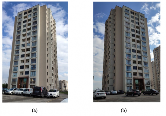

The study was carried out in two blocks of identical buildings on the same site. These residential building block have the same number of stories, flats and similar number of residents.
Both buildings blocks have stories and 62 flats. In the study, the block names are referred to as B2 and B3, as they are named in the site. (Image 1).
IMAGE 1: Outside view of the flats (a) Block B2, (b) Block B3
IMAGE 1: Outside view of the flats (a) Block B2, (b) Block B3 (Images courtesy of the author)

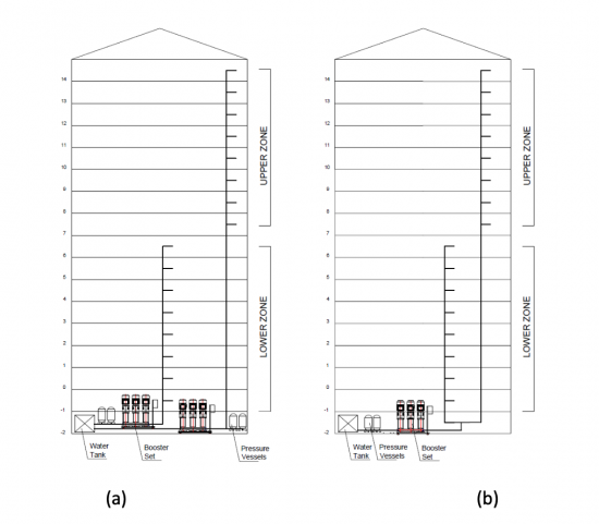

In the building design, the pressurization of clean water is provided by booster sets. The city water feeds two water tanks of 25 cubic meters (m3), in total 50 m3 in each building on the second floor. In both buildings, the system is divided in two zones, upper and lower zones. The pump systems that pressurize each zone is designed separately. The lower zone supplies water from the first to the sixth floors and the upper zone from seventh to the 14th floors. This is what the clean water system design looks like in blocks B2 and B3. (Image 2)

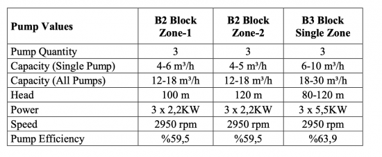

Block B2’s clean water system type is a two-zone system. The building has two zones, each fed with a separate booster. In the lower zone, a constant 6 bar pressure is provided with two 200-liter pressure vessel tanks. In the upper zone, a constant 10 bar pressure is provided with two 300-liter pressure vessel tanks. Booster information of the lower zone is shown in Table 1, the upper zone in Image 2.
IMAGE 2: The system diagrams. (a) Block B2, double zone system with two boosters, (b) Block B3, Double zone system with single booster (This application has been defined as single zone in the study)
Block B3 clean water system type is a double zone system. The building has two zones, fed with one booster. Two 300-liter pressure vessel tanks that provide a constant pressure of 10 bar are used in the system. (Image 2).

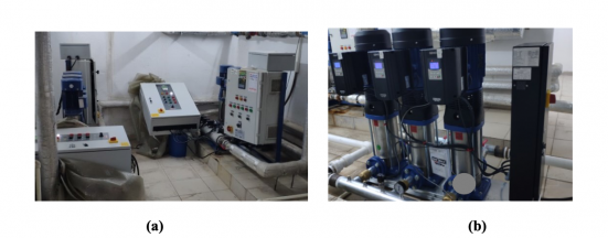

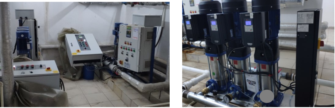

IMAGE 3: (a) Booster sets of double zone system, (b) Booster set of single zone system
In both buildings, boosters of the same brand were used. The boosters used stainless steel, vertical multi-stage centrifugal pumps. A frequency converter was used to run the boosters in both buildings.
All boosters have three pumps. (Image 3).
Table 1 : Booster set nameplate values

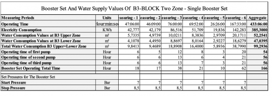

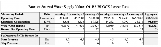

The water consumption figures were taken from the water meters in the buildings and the electricity consumption from the electricity meters attached to the boosters. The measuring period lasted about three weeks and data readings were done three times a week on average. With readings through fixed periods, figures from both buildings are examined. The water consumption in the buildings are measured and the energy consumption of the boosters are evaluated. Thus, the most efficient method for both buildings are determined.

Table 3 : Block B2, Lower zone measurements
Table 3: Block B2, Lower zone measurements
Table 4 : Block B3, Single zone measurements

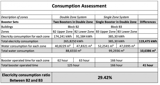

Following the measurements and readings, the consumption differences between the two buildings are seen clearly. (Table 5).
As a first assessment, when the operation durations of the booster sets are considered, 41 hours of extra operation throughout the 433-hour experiment are seen clearly. Although the lower and the upper pressure set values, the pressure vessel tank pressures and volumes are all equal, the booster operating in the single zone worked 41 more hours for water supply.

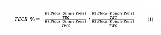

equation 1
Equation 1
When the differences between the total energy consumptions are considered, it shows that the boosting in the single zone required 119,475 kilowatt hours (kWh) more energy. Even though the buildings are identical and have similar occupancy rates, a difference of 10, 6386 m3 water consumption was measured. The water consumption in the single zone building is 10, 6386 m3 more. It is assumed that the electricity consumption was not affected by this difference. Although the overall water consumption of the residents in Block B3 is higher, when the two buildings are compared by unit, it is still clearly seen that the single zone system consumed more energy than the double-zone system. Table 2,3 and 4 can be seen in detail.
The main reason of this high consumption is that in the single zone system, the boosters operate at a further distance from their best efficiency point (BEP). Additionally, the pressure reducing equipment used to protect the individual water supply systems of the flats on the first to sixth floor caused the energy to go to waste.
System losses in both buildings are assumed equal as both building have the same water supply system.
Table 5 : Energy and water consumption and operating assessment between Block B2 and B3
Table 5: Energy and water consumption and operating assessment between Block B2 and B3
When the energy consumptions are compared to the water consumptions, the total energy consumption ratio (TECR) was calculated independently from the total water consumption and the difference in between was calculated to be %29,42 higher. The single zone booster in Block B3 consumed %29,42 more energy than the double zone system.
