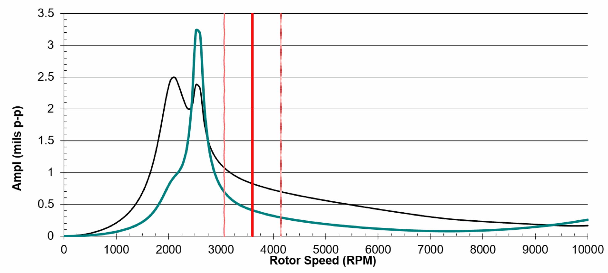

Image 4 illustrates the amplitude of the shaft displacement of a flexible shaft through a range of rpm. The critical first speed occurs at 2,520 rpm and can be seen as an increase in displacement from less than 0.5 mils (mil = 0.001 inch) p-p to more than 2 mils p-p in the X-dimension (black line) and more than 3 mils p-p in the Y-dimension (blue line). The red line represents 60 Hz operating speed of the motor. The dotted red lines illustrate the 15% separation margin required by the American Petroleum Institute (API) Specification 541 between the critical first speed and the operating speed. This particular shaft profile would more typically be found in a motor designed for continuous speed applications.
Stiff shafts work for VFD applications. Using a shaft with the first critical speed past the range of operation allows a VFD motor to provide the required speed and operational capacity for a full range up to operating speed without the requirement for blocked out speed range. Operators and systems designers should be careful to understand their VFD operational requirements and to specify stiff shaft motors when they desire broad speed range capability.
