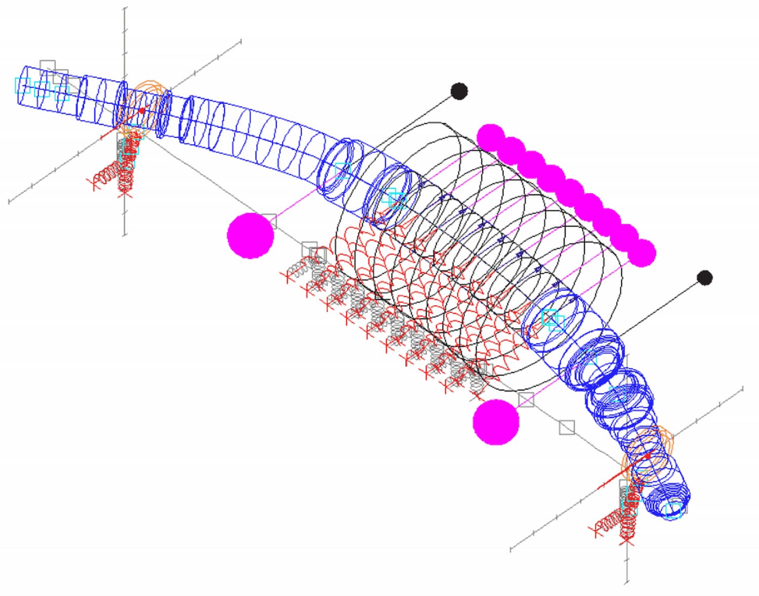

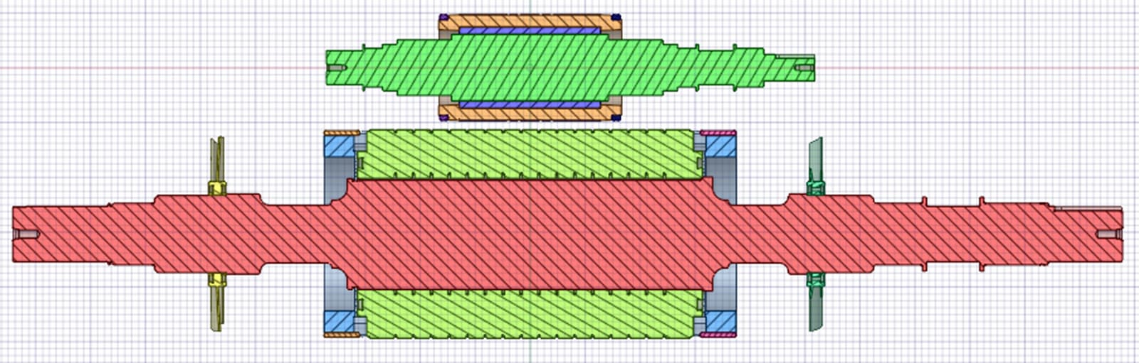

The two main motor shaft design options are stiff and flexible. All motor drive shafts will have a resonance frequency where the shaft will begin to bend during use and threaten the integrity of the motor. By traditional definition, resonance frequencies occur when the excitation of a material or structure aligns with its natural frequency to create amplification—sometimes uncontrolled. There may be multiple critical speeds in theory, but in practice, users are normally concerned only with the first critical speed.
Flexible shaft motors have the characteristic of at least one critical speed associated with a bending mode below the designed, base operating speed of the motor. Stiff shaft motors are designed with the first critical speed associated with a bending mode that would be above the designed operating speed of the motor.
Designing motors for lower power applications is simpler. Most motors below 800 hp will have a rotor with a stiff shaft design as standard. For large motors with high power requirements (above 8,000 hp), motor rotors will normally only be available as flexible shafts without moving to what is referred to as high speed motors. Therefore, for typical two-pole motors, stiff shaft or flexible shaft design becomes a critical motor characteristic between 800 and 8,000 hp for motors to be operated on a VFD.

Image 4 illustrates the amplitude of the shaft displacement of a flexible shaft through a range of rpm. The critical first speed occurs at 2,520 rpm and can be seen as an increase in displacement from less than 0.5 mils (mil = 0.001 inch) p-p to more than 2 mils p-p in the X-dimension (black line) and more than 3 mils p-p in the Y-dimension (blue line). The red line represents 60 Hz operating speed of the motor. The dotted red lines illustrate the 15% separation margin required by the American Petroleum Institute (API) Specification 541 between the critical first speed and the operating speed. This particular shaft profile would more typically be found in a motor designed for continuous speed applications.
Stiff shafts work for VFD applications. Using a shaft with the first critical speed past the range of operation allows a VFD motor to provide the required speed and operational capacity for a full range up to operating speed without the requirement for blocked out speed range. Operators and systems designers should be careful to understand their VFD operational requirements and to specify stiff shaft motors when they desire broad speed range capability.
Rotor dynamics can be quite complex and will be affected by many other variables besides the staff stiffness and rpm. The motor enclosure—weather protected Type II (WPII), totally enclosed water to air-cooled (TEWAC), totally enclosed air to air-cooled (TEAAC), totally enclosed fan-cooled (TEFC)—and the motor voltage rating will also combine to determine when a motor standard design is stiff or flexible. When considering a new motor for a VFD pump application, it is recommended that the motor manufacturer be contacted to ensure that a motor design is a stiff shaft instead of a flexible shaft design.
