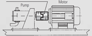

Since careful alignment is also required, alternate mounting options are availab
Since careful alignment is also required, alternate mounting options are available to simplify alignment in foot mounted systems, which are more difficult to align than C-face mounts.

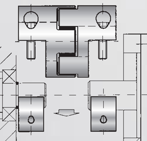

Jaw Type Couplings
For proper ATEX qualification, torque and misalignment ratings are reduced by 30 percent. With jaw type couplings, special conductive materials are also used for the injection molded urethane inserts, to guarantee a consistent path to ground for any electrostatic charge that may build up during operation. One advantage of using jaw type couplings is that they have a high torque density, meaning that the 30 percent safety factor used in the selection of a torque rating does not normally result in a coupling that is disproportionately large.
Since careful alignment is also required, alternate mounting options are available to simplify alignment in foot mounted systems, which are more difficult to align than C-face mounts. Full split collars allow the installer to carefully dial in motor and pump shaft locations for subsequent lateral installation of the coupling. This also helps to make servicing the coupling quick and convenient.
Additional options include dual flexture couplings, which can tolerate much greater amounts of misalignment, facilitating easier assembly through a wider tolerance. Inspection intervals, installation procedures and other detailed directions are then provided in the accompanying documentation, and serialized inscriptions are made on the couplings, detailing manufacturer accreditation and conformance to the standard.

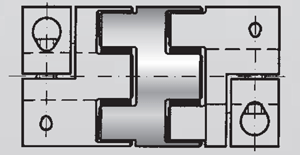

 Dual flex couplings can tolerate much greater amounts of misalignment, facilitat
Dual flex couplings can tolerate much greater amounts of misalignment, facilitating easier assembly through a wider tolerance.
