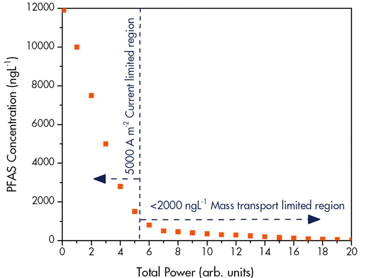

Image 1 illustrates how the PFAS destruction rate is linear and only limited by the charge (electric current) reaching the electrode surface at concentrations above ~2,000 ngL-1. However, below this concentration range, EOx becomes increasingly inefficient because it is now limited by the rate of mass-transport to the electrode surface.
Curve of PFAS reduction as a function of total power. At concentration levels > 2,000 ngL-1, the reduction rate is current limited; at levels < 2,000 ngL-1, the reduction is mass-transport limited.
IMAGE 1: Curve of PFAS reduction as a function of total power. At concentration levels > 2,000 ngL-1, the reduction rate is current limited; at levels < 2,000 ngL-1, the reduction is mass-transport limited. (Images courtesy of Element Six)

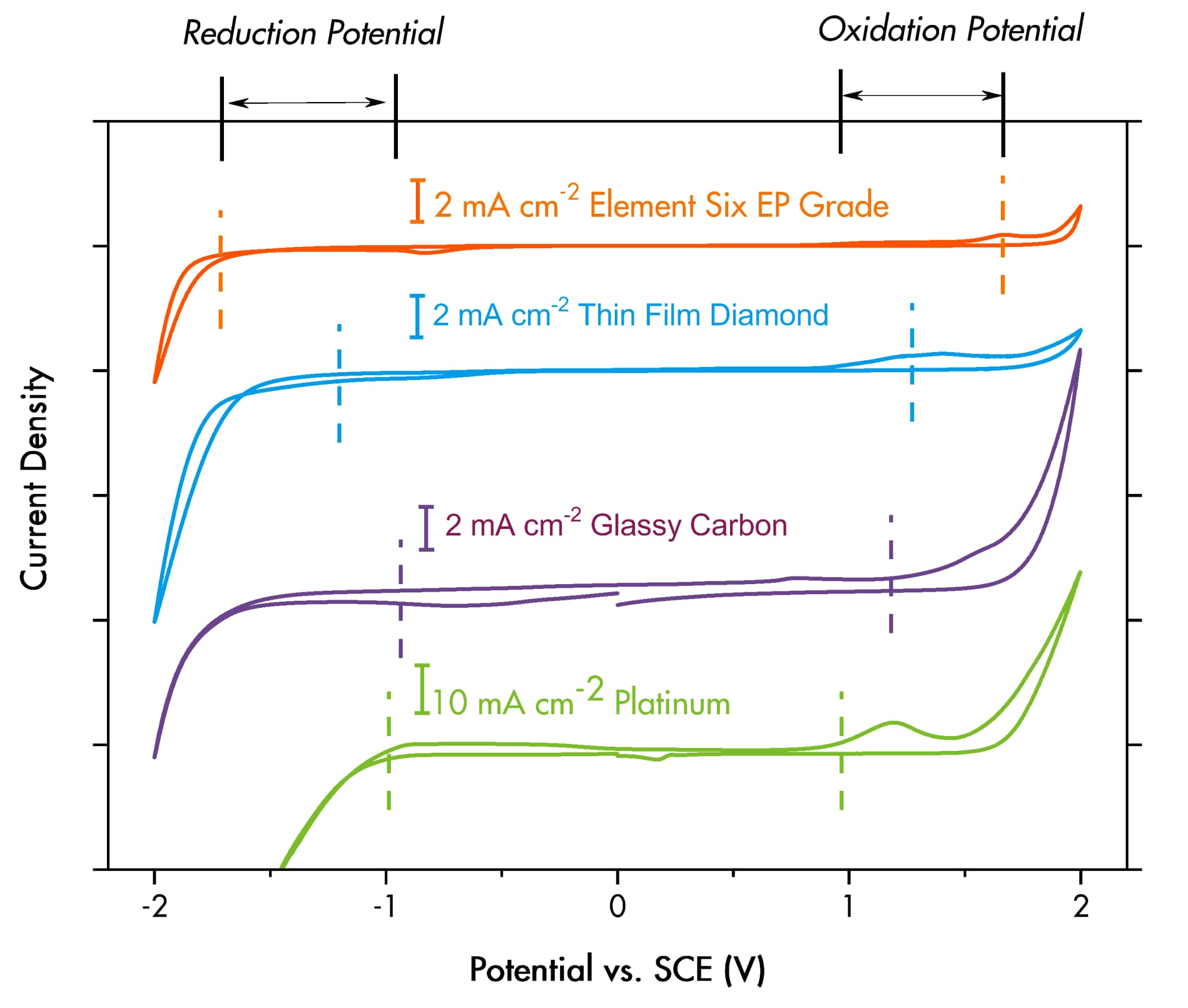

IMAGE 3: Free-standing BDD electrodes have the widest solvent window and therefore the highest current density and oxidation potential of any electrode type.

  • have the widest solvent window (Image 3), operating at the highest current densities, up to 30,000 ampere per meter squared (A/m2), thus providing the highest oxidation potential (This is the most important for short-chain PFAS destruction.)
