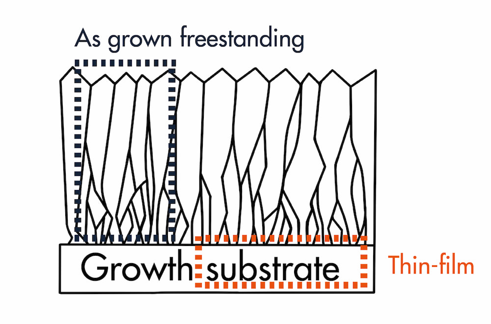

- thin-film BDD electrodes with a thin diamond layer, normally < 20 µm thick, coating a metallic substrate
- free-standing BDD electrodes that are solid diamond, normally > 300 µm thick, with no metal or silicon substrate (Image 2)
IMAGE 2: Thin-film BDD is a thin layer of BDD, normally < 20 microns thick, attached to a substrate. Free-standing BDD, normally > 300 microns thick, is separated from the substrate after growth. Free-standing BDD can either be used as grown or polished on one or both sides.
Thin-film BDD electrodes are made in hot-filament chemical vapor deposition (CVD) synthesis tools. Most commercial suppliers of thin-film BDD electrodes use refractory metals as the substrate (such as niobium, tantalum and tungsten) with the costs of these metals being a major factor in the total purchase price of commercially available thin-film BDD electrodes. Conversely, free-standing BDD electrodes are made in microwave CVD synthesis tools where the diamond is separated from a growth substrate, which is then reused.
