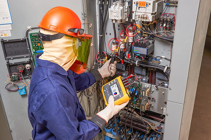

Before starting electrical maintenance work or taking initial power quality measurements, it’s a best practice to frame up exactly what is happening, especially if you are working in an unfamiliar environment. If specific machinery is involved, speaking to the equipment operator can provide insight into the potential cause of a problem. Having a log of symptoms with the date and time they occurred can also be useful for comparing with the data from the power quality measurements.![Matching the labeling on each connector to the corresponding label](/sites/default/files/1217/F-1736_06a_h-alt.jpg)

Connect the voltage leads to the measurement device, being careful to match the labeling on each connector to the corresponding label on the instrument. Next, connect the voltage leads to the circuit, again paying attention to the connector labels and circuit phases. Verify that the alligator measurement clip is secure and the voltage leads are supported such that they do not pull the lead off the circuit. If connecting to a terminal block with recessed screws, magnetic tipped probes are recommended. Connect the current probes to the circuit, paying attention to the arrow denoting direction of current flow along with matching the same phase with the voltage lead. If powering the instrument from the measurement leads, connect the jumper cables from the stackable plugs on the instrument to the corresponding inputs on the power supply. Otherwise, connect the alternating current (AC) power cord.4. Verify Connections
