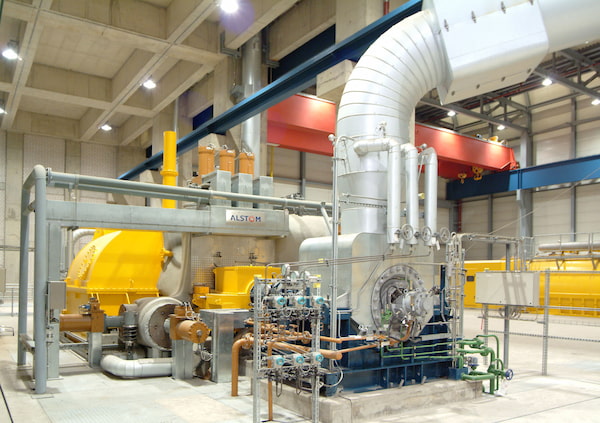

With its 40,000-kW (53,640-hp) drive rating, the CHTA 140/5 feed pump in the Niederaussem lignite-fired power station near Cologne is one of the two largest feed pumps ever built.
The new power station is situated in the immediate vicinity of the open-cast lignite mining sites in the Cologne/Aachen area. Its power output of 1,000-MW and net efficiency of 43 percent make it the world's most modern and efficient power station. This excellent performance comes from all the components of the power station unit being perfectly matched to the process as a whole.
The CHTA is a so-called “hundred percent pump,” meaning it is not backed up by a stand-by pump. Plant outages are every power station operator’s nightmare because of the immense costs involved. This pump, therefore, has to be hard-wearing, insensitive to extreme duty conditions, and provide reliable service for long periods without maintenance.
That’s not all. Energy supply companies expect very high efficiency because every kW not consumed by the pump – which operates around the clock – can be sold to their clients.
Turbine Drives Pump
The pump is driven by its own steam turbine with continuously variable speed control. The turbine has a power rating 44-MW and is equipped with two shaft ends (see Figure 1). One shaft end is directly coupled to the CHTA pump.

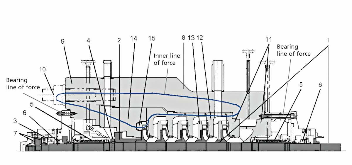

Figure 7. Main lines of force acting on the stationary components.
The pressure distribution around the impeller gives rise to a hydraulic axial thrust (see Figure 8) which is transmitted to the shaft by means of a separate split ring for every impeller.
Figure 8. Axial thrust balancing.
The axial thrust, which increases in intensity from one impeller to the next and can eventually reach a maximum value of 240 tons, is reliably balanced by a doubled drum (see Figure 7, part 2). Thanks to its hydraulic properties, the double drum permanently reduces the forces acting on the thrust bearing and thereby protects it against overloading, even in the event of sudden transient load changes.

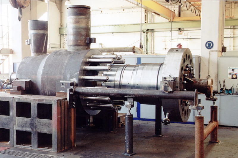

The most striking feature about the CHTA 140/5 on first sight is probably the pressure boundary. It consists of a forged barrel casing (see Figure 7, part 8) and a cover (see Figure 7, part 9) which – securely located by the main tie bolts (see Figure 7, part 10) – is designed to retain the internal pump pressure.
The tie bolts are tightened with a hydraulic tensioning tool. This allows the bolts to be tightened unaffected by torsion or flexion moments. These bolts withstand higher loads than any others in the entire pump and must be designed with the required reliability.
