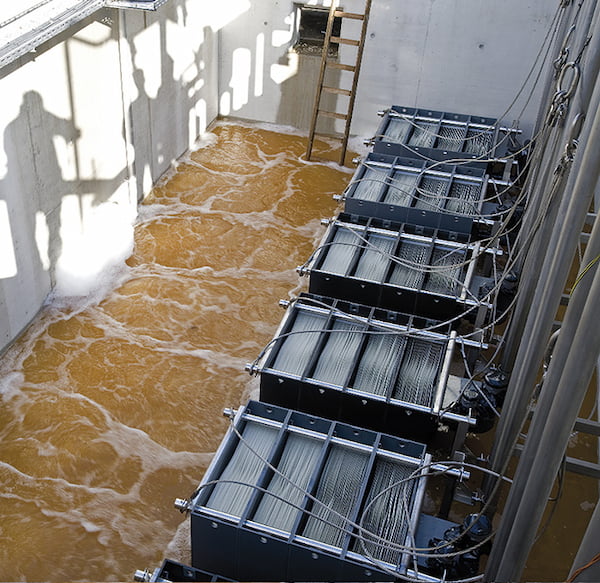

Elimination of micropollutants in biologically treated wastewater has become increasingly important. One reason for this is that contamination of the environment by these substances has now been clearly proven. The regulatory framework in different jurisdictions is expected to be tightened—and threshold values increased—for micropollutants in cleaned wastewater that is discharged into the aquatic environment. Most of the currently applied process combinations do not include membrane filtration, although this process is often advantageous, in particular with respect to the issues of multi-resistant germs, antibiotic drugs and microplastic particles that can come from a wide variety of sources. Today, a combination of powdered activated carbon and subsequent sand filtration is mainly used to eliminate micropollutants. This process can reduce trace substances like drug residues in the effluent of a wastewater treatment plant.
More to Consider as Discarded Medicine Causes New Issues
However, it is disadvantageous in that the sand filter does not ensure complete separation of activated carbon particles. Furthermore, sand filters do not function as a barrier for microplastics and multidrug-resistant germs. An increasing use of antibiotics in human and veterinary medicine has led to a steady increase of these germs in the environment. Since multidrug-resistant microorganisms are able to transfer resistance genes to other bacterial strains, a health risk will emerge. Due to the high concentration of microorganisms and the contamination by antibiotics coming into the water supply, wastewater treatment plants are considered to be a source for storage and distribution of multidrug-resistant microorganisms. These problems are expected to bring stricter measures and regulations from places such as within the European Wastewater Directive. It is apparent that besides treating wastewater by activated carbon adsorption and sand filtration, further treatment steps must be implemented.
