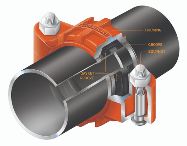

Grooved Basics
Grooved pipe joining employs a mechanical coupling—consisting of housings, an elastomeric gasket and nuts and bolts—to join grooved-end pipe, valves, fittings, equipment and accessories.
The pipe groove is made by cold forming (roll grooving) or machining (cut grooving) a groove into the ends of a pipe. To assemble the joint, two grooved pipe ends—or a pipe end and a valve or fitting, etc.—are abutted. The gasket is positioned around the joint. The housings are placed over the gasket, and finally, the bolts and nuts are tightened to secure the housings together. In the installed state, the coupling housings encase the gasket and engage the grooves around the circumference of the pipe to create a leak-tight seal in a self-restrained pipe joint.
Rigid couplings provide a mechanical and frictional interlock onto the pipe ends sufficient to result in a rigid joint with characteristics similar to those of welded or flanged joints, because all the piping remains in strict alignment and is not subject to deflection during operation. Flexible couplings permit controlled linear and angular movement, which can accommodate thermal expansion and contraction, deflection, seismic movement and vibration.
grooved1
The anatomy of grooved pipe joining

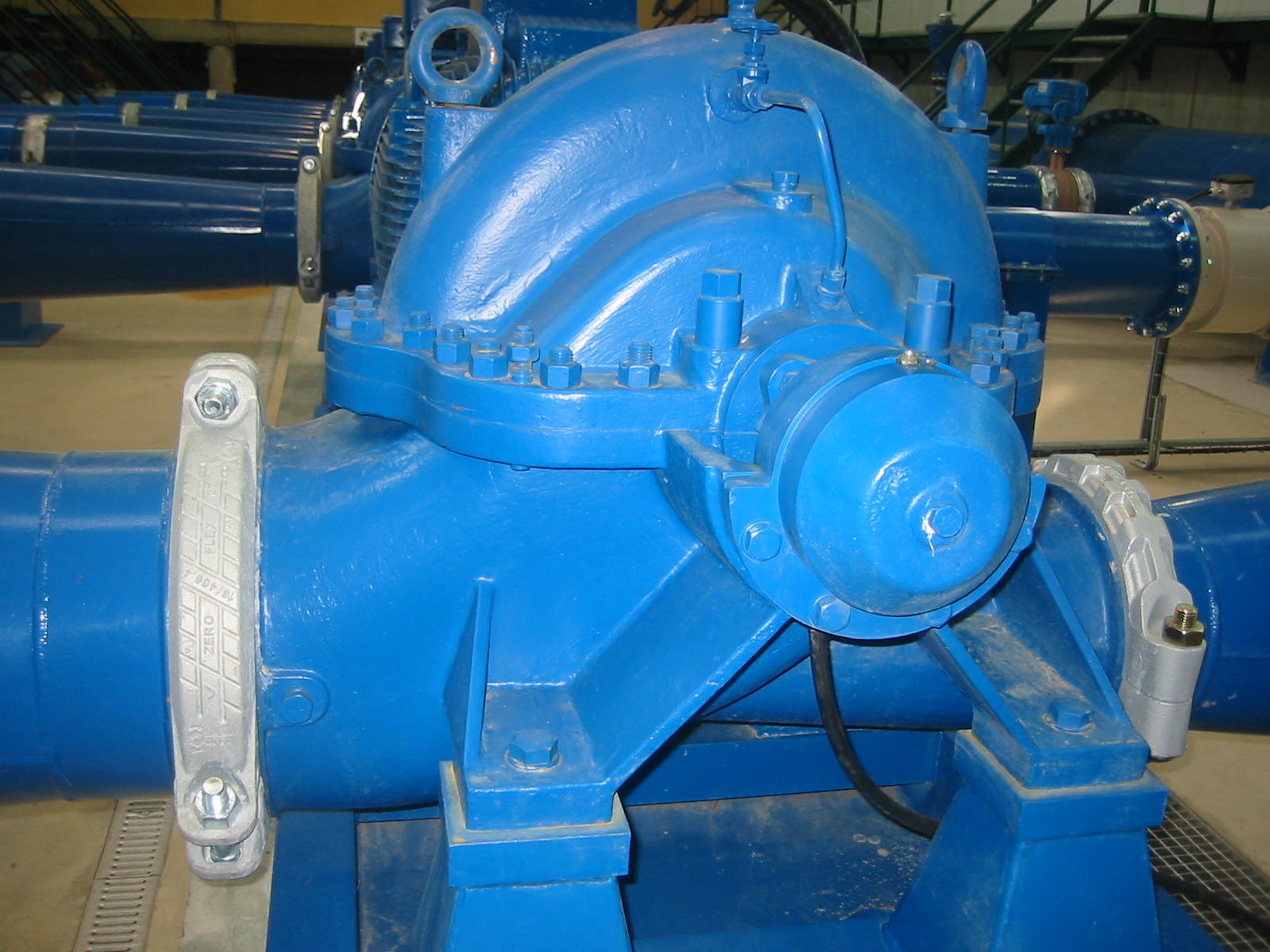

Throughout the life of the system, flanging requires significant maintenance to sustain joint integrity. Pumps and other equipment frequently vibrate and are subject to noise in the piping system. For example, oscillatory forces can be generated due to the lack of balance of rotating components, such as in pump vanes. Although field balancing can reduce this, it requires specialized equipment, which can become difficult, expensive and impractical.
grooved3
Piping connected to a pump using the grooved-pipe method

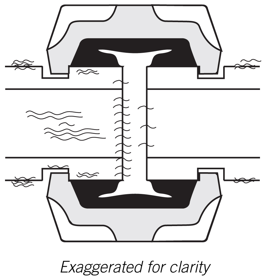

Vibration Dampening
Grooved couplings accommodate vibration without the need for specialty products that require periodic repair or replacement. The resilient elastomeric gasket contained within both flexible and rigid couplings aids in the dampening of noise and vibration. The design of the coupling enables the gasket to seal against the pipe, while the housing provides both space for the elastomeric material to flex and containment to prevent overstretching.
Flexible, grooved systems allow the pipe to move and vibrate within the coupling, localizing the vibrations generated by equipment and reducing the amount of noise transmitted through the piping system. The design of the grooved joint permits this movement without wearing out the gasket.
Testing commissioned by a grooved couplings and fittings manufacturer and conducted by Seattle-based SSA Acoustics LLP shows that grooved couplings provide greater vibration isolation and sound attenuation characteristics than flexible metal or elastomeric arch-type connectors. The ideal arrangement for accommodating equipment vibration is the placement of three flexible couplings in close proximity to the vibration source. The use of additional couplings, whether flexible or rigid, will further reduce the transmission of vibration.
System vibration and other forces can lead to joint problems in a flanged system. Flanging employs a series of bolts and nuts to compress a gasket between two flat-faced, flanged pipe ends. The torque on the bolts employs a high compressive load on the internal gasket, which can cause the gasket to adhere to one or both of the flanges. When the joint is disassembled, the gasket can tear, resulting in failure upon reinstallation. Furthermore, the bolts and nuts of the flanged union absorb system forces. With time, they can relax due to surges, system working pressure, vibration, expansion and contraction. When the bolts lose tension, the gasket can “slip,” which can result in a leak. Flange gaskets can take on compression with time, also resulting in leakage. To prevent or stop leaks, routine bolt and nut tightening is required.
The ability of grooved couplings to accommodate system vibration reduces the risk of joint issues. A coupling holds the gasket in precise compression from the outside of the pipe joint. While the bolts and nuts hold the housings together, the coupling itself is what holds the pipe together. The gasket absorbs system forces, not the bolts and nuts. Throughout the life of the system, the nuts and bolts do not require regular retightening and will not slip or relax, therefore maintaining a leak-tight seal. The gasket of a grooved coupling has a C-shaped, cross section seal that is durable and can handle significant compressive and cyclical loading. A system can be pressurized and depressurized repeatedly without fatiguing the rubber.
grooved2
Grooved couplings accommodate vibration while flexible and rigid couplings dampen noise and vibration.
