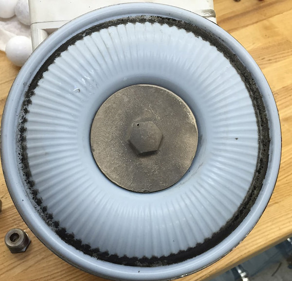

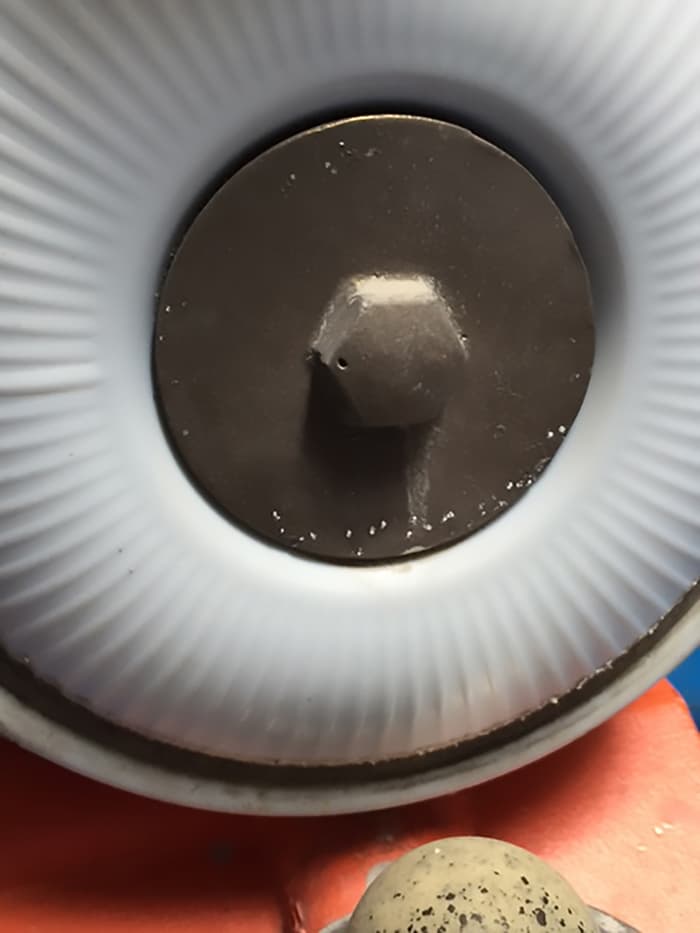

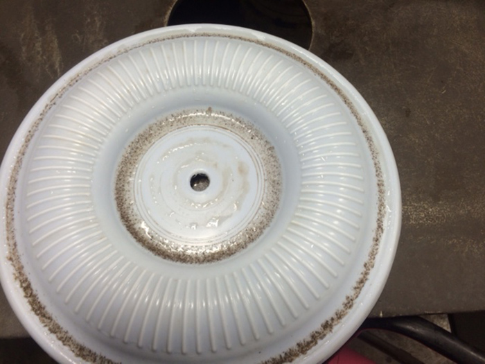

Image 2. The ePTFE composite diaphragm after 24 continuous hours of testing (155,000 cycles and 3,456 gallons pumped)
Expanded and tensilized PTFE, or ePTFE, is manufactured by a proprietary process. ePTFE provides toughness and abrasion resistance, while a rubber backing lends flexibility.

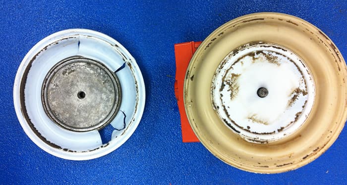

Internal testing was conducted to compare the performance of ePTFE composite diaphragms with two-piece, rubber-backed PTFE diaphragms (see Images 1-5). It involved two identical 1.5-inch inlet/outlet air operated double diaphragm (AODD) pumps at the same elevation and air inlet, media inlet and outlet pressures. One was fitted with an ePTFE composite diaphragm, and the other with a two-piece diaphragm with PTFE facing the media and a thermoplastic elastomer facing the air side.Image 3. The ePTFE/fabric/rubber diaphragm after 194 continuous hours of testing (1,250,000 cycles and 27,000 gallons pumped)

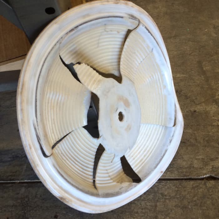

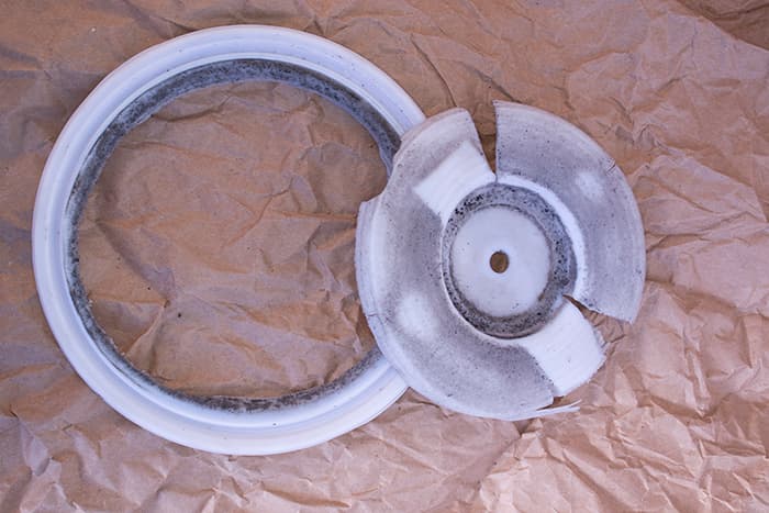

Image 4. The ePTFE composite diaphragm after 372 continuous hours of testing (2,400,000 cycles and 53,000; gallons pumped). The ePTFE began to tear, but did not break apart from the diaphragm.

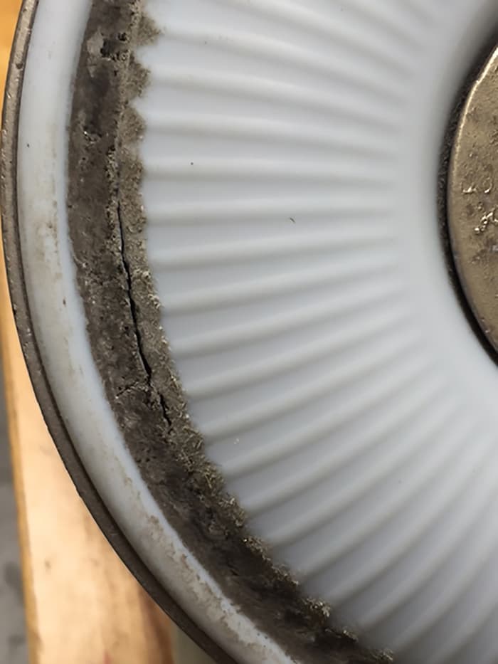

Delta Tech Service Inc. in Benicia, California, specializes in decontaminating oil refinery equipment. The company designs and fabricates skids that utilize two 3-inch AODD pumps joined at the manifolds, allowing users to simultaneously operate one or both pumps. One of the challenges in the field was the short life of the fluoroelastomer diaphragms that came with the pumps. Ethylene propylene diene monomer (EPDM) and conventional skived PTFE diaphragms with thermoplastic elastomer backings were used, but none lasted longer than a 30-day rental period (see Images 6-7).Image 5. Conventional skived PTFE overlays after 24 continuous hours of testing (155,000 cycles and 3,456 gallons pumped)

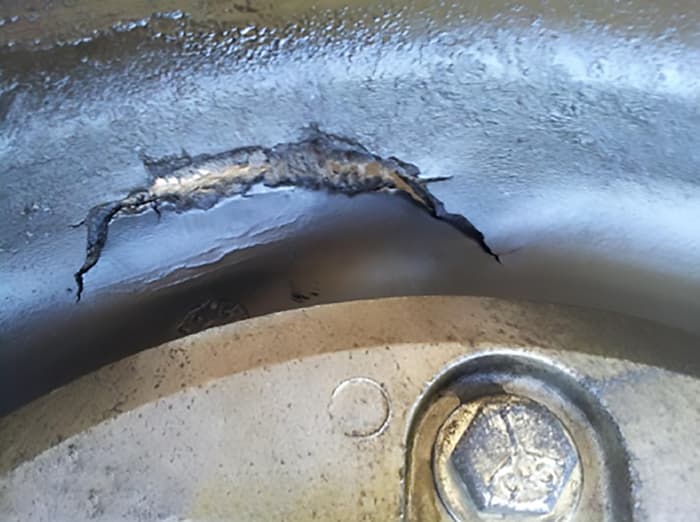

Image 6. The two-piece PTFE and thermoplastic elastomer diaphragm is shown. The conventional PTFE separated from the assembly, and pieces of the diaphragm entered the media after abrasives and flexural stresses tore it apart.
