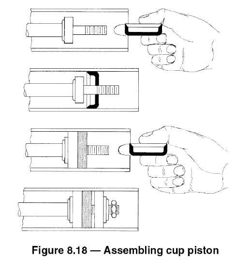

Q. What is the recommended procedure for installing piston cups on a reciprocating pump?
A. Piston cups are primarily used on piston heads, plungers or rams. They are used because of economical costs, excellent service life, efficient assembly, universal acceptance and simple accessories. More specifically, synthetic rubber piston cups operate continuously at high temperatures. These packing cups can be molded of synthetic rubber and other elastomers that resist strong acids and alkalies. An abbreviation of the recommended installation procedure for these cups is listed below (see Figure 8.17):
1.    Ensure that no wear has occurred in the cylinder liner, and make sure that the cylinder liner and the packing cups are clean.
2.    Lubricate the outside diameter of the surface of the packing cups.
3.    Push the piston rod into the cylinder, and place the piston head over the piston rod.
4.    Insert the first packing cup, holding the cup horizontally until the lip has entered the liner (see Figure 8.18). Turn the cup to a vertical position, and lightly tap the cup into position over the hub.
5.    Slip the spacer disc over the piston rod, and push it tightly against the first cup.
6.    Insert the second cup, and use the same approach above to place the follower disc over the piston rod.

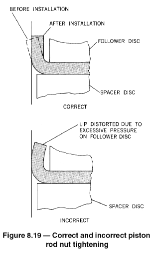

7.    Apply and tighten the piston rod nut, making sure to not tighten it to the point where the cup becomes distorted, as seen in Figure 8.19.

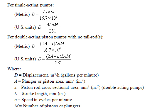

Q. How is pump displacement for a direct-acting reciprocating steam pump calculated?
A. The displacement of a reciprocating pump is the volume swept by all pistons or plungers per unit time. Deduction for piston rod volume is made on double-acting piston type pumps when calculating displacement.
