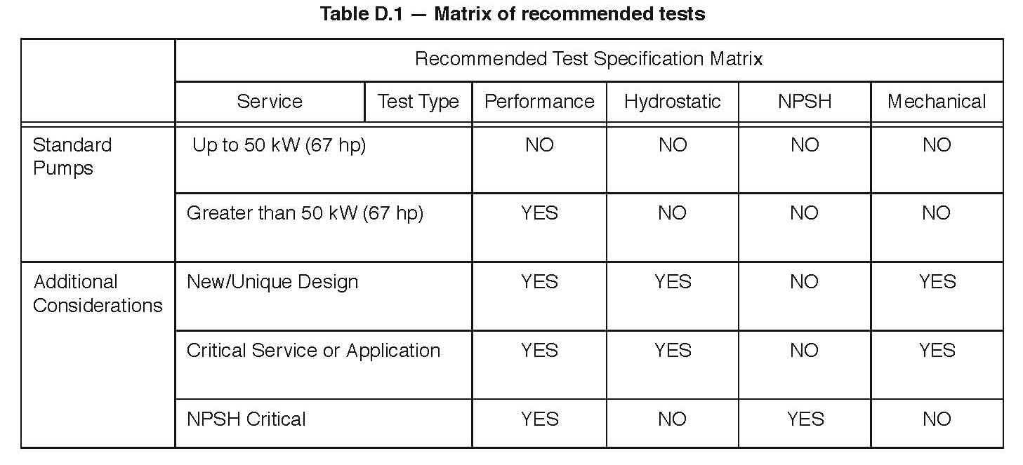

Q.  When purchasing new rotodynamic pumps, what type of acceptance testing is recommended?
A.  Purchasers of rotodynamic pumps should specify acceptance testing that will verify the rate of flow, head produced and power required. The costs of acceptance tests and special tests should be clearly stated in the contract. Specifying tighter acceptance tolerances can lead to higher testing costs and increased lead times. When NPSH testing is specified, test costs will be higher because the tested pump must undergo a different and more time-consuming test, often performed with a different test set-up requiring additional assembly and tear-down time.
HI graph
Figure 1. Recommended tests for different pumps and services

Figure 1 should be used as a guideline. For normally manufactured pumps, users may consider a certificate of compliance instead of actual testing.
