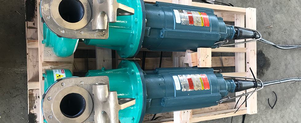

Another option is to use a high-quality chopper or cutter pump instead of standard sewage pumps. They also help ensure debris is cut down to make it easy to pump or pass through piping. There is a difference between chopper and grinder pumps.
Grinder pumps, not to be confused with grinders/macerators, are generally smaller pumps suitable for individual
home use, but can struggle with clothing or rags. Chopper and cutter pumps have a more heavy-duty cutting blade on the inlet and are available with much higher horsepower motors. This makes them suitable for larger pump stations that will see large amounts of debris.
