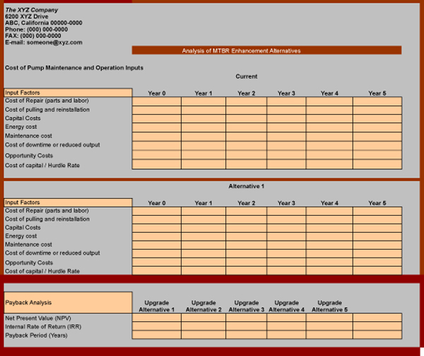

Figure 1. Payback analysis model
Calculating Payback
Figure 1 shows a sample of a payback analysis model that includes the specific inputs that would enable the user to perform a payback analysis.
In most real-world situations, you will not have all the information for all the categories shown in Figure 1, but this shows the type and scope of information that would be useful when evaluating the payback on a capital investment to enhance MTBR and energy efficiency.
Analysis Method
The first step to a financial analysis on the benefits of a capital expenditure to enhance a sealing system's MTBR and energy efficiency is to input the costs for the current situation. Since complete information often will not be available, the analysis will necessarily be based on the available data or supplemented with documented reasonable assumptions.
The second step is to input the CAPEX required to achieve the enhancement in the MTBR. The CAPEX is treated as a cash expenditure incurred in year zero when doing NPV and IRR calculations.
The third step is to enter the expected operating costs after the improvements have been made to enhance the MTBR and/or energy efficiency and to net those costs against the costs for the current situation. The resulting savings are the cash inflows that provide a payback on the invested capital. It is important to show the years in which those savings will occur to properly calculate NPV and IRR.
The final step is to run the calculations for NPV, IRR and the payback period using the CAPEX as a negative input in year zero, the cost of capital as the discount rate and the cost savings for each year over a period of time as the positive cash flows generated as a result of the investment. Typical time periods would be five to ten years. With these inputs, it is quite easy to use the NPV and IRR formulas available in Microsoft Excel. The calculations can be done by hand, but this can be quite cumbersome.
