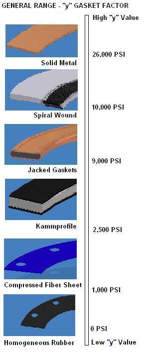

Minimum gasket seating stress (SgminS) can be defined as the Y value in ASME Code calculations. This is basically the absolute minimum stress needed to conform to the flanges, assuming that there is little or no internal pressure. Most gasket manufacturers can provide these values on their gasket materials. Often, these values are determined with low-pressure leakage tests on each gasket material. This minimum stress value will normally be used only in flange design calculations.

Y value ranges for gasket materials
Figure 1. Y value ranges for gasket materials
