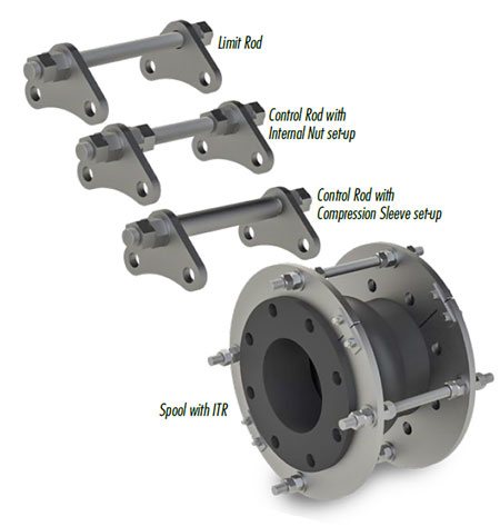

Control Rods
Absent from these photos is the expansion joint’s trusty sidekick: the control rods. Control rods are not necessarily required for every installation, but they are always a good idea. Consider control rods as inexpensive insurance, preventing expansion joints from overextending or over-compressing. A control rod assembly will avoid problems related to excessive movement.
Loose Bolts
One more problem where a rubber joint failed is loose bolts. This is no exaggeration: every failure site had expansion joints with bolts that could be removed without tools (even on joints that were not involved in the failure). Although manufacturers have different bolt tightening requirements, the one common thread (bad pun intended) is that bolts must be re-tightened after the initial installation.
![Control rods](/sites/default/files/0120/Sealing-Sense-8.jpg)
What do these failures have in common? They all boil down to human error. Each incident could have been avoided by following the manufacturer’s instructions and effectively communicating the application requirements prior to ordering the expansion joint. Convincing people to follow instructions can be a futile effort. Communicating application requirements, by contrast, is easy. Appendix L, page 49, of the “Expansion Joints Piping Technical Handbook” has one single information sheet that can eliminate many of the problems shown in this article.
