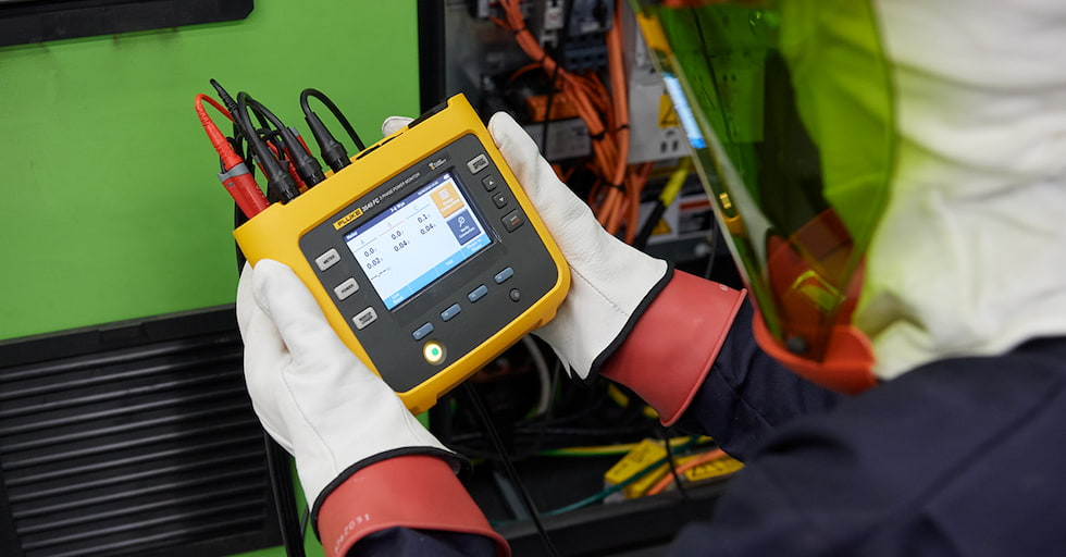

Fortunately, Crestline had the right tool at the right time—a three-phase power monitor—to help them mitigate the issue.
This monitor helped the maintenance staff measure:
- single, split or three-phase loads
- voltage, current and frequency
- total harmonic distortion
- active power, nonactive power and power factor

After further troubleshooting, the maintenance team recognized it was not a mechanical problem and began focusing on possible electrical issues. Dietz knew the power monitor’s capabilities and immediately put the tool to use.
“It was the three-phase power monitor that enabled us to see that the pumps, and ultimately the entire station, weren’t grounding properly,” Dietz said. “We isolated it down to harmonics and line voltage fluctuations that were causing varying amperages and VFD anomalies. We were able to diagnose, modify and mitigate the problem by using the power monitor.”
