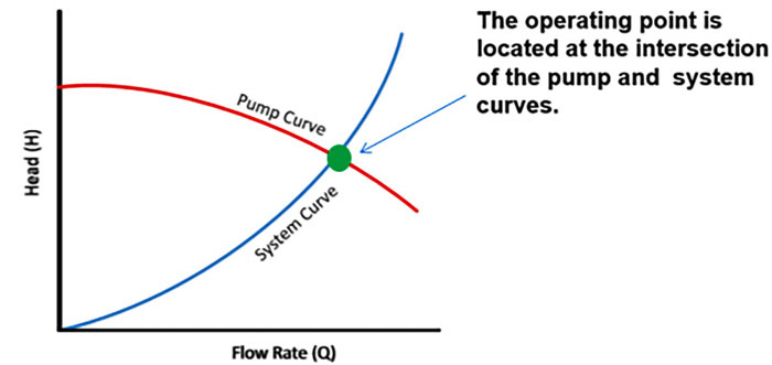

A system curve graphically defines the amount of head pressure required to move a fluid through a hydraulic piping system as a function of flow rate. Head, which is measured in meters or feet, is the maximum height (pressure) a pump can achieve. In wastewater applications this is the vertical lift from the inlet of the pump to the discharge of the pipe. Flow is measured in gallons per minute. The system curve is derived from the two major system-related aspects that a pump must surmount:- Static head: the fluid elevation (uphill) differences between pump supply and pump, and the pressure differences between pump supply and pump system

Typically provided by a pump manufacturer, a pump curve describes the relation between the flow rate and the head for the actual pump (essentially data about a given pump’s ability to produce flow against certain head). It is only good for one specific pump, with one impeller diameter, operating at one speed and has one best efficiency point (BEP). A pump operates where the pump curve and system curve intersect. As conditions change and the operating point moves along the pump curve, the pump efficiency changes.Popular Pump Control Methods & Their Inefficiencies

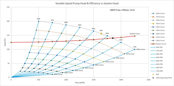

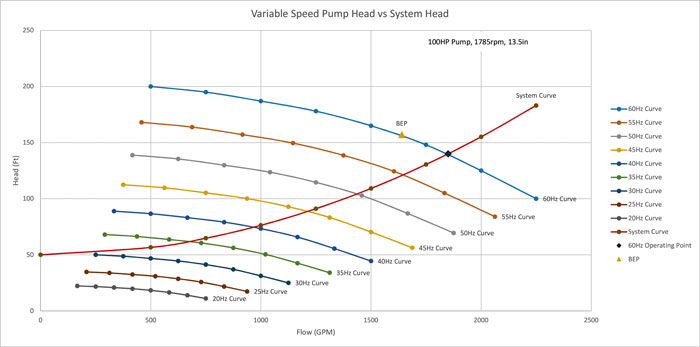

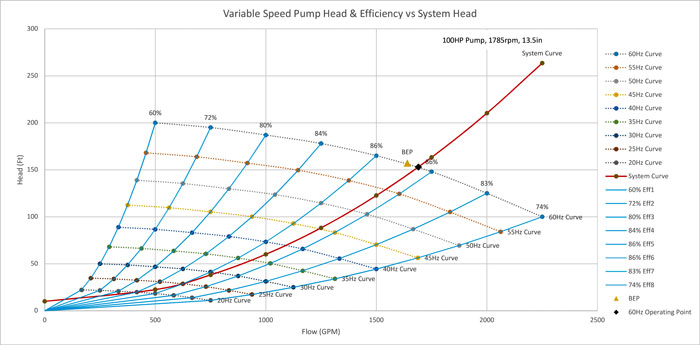

There is a common misperception that pairing a pump motor with a VFD simply moves the operating point up and down the pump curve. In reality, for every 0.1 hertz (Hz) of speed regulation, a new pump curve is developed, resulting in an infinite number of pump curves generated by varying the speed of a pump. But the system curve stays the same, so as speed is varied the flow in the pumping system is also varied, dropping the amount of frictional head pressure as flow decreases. The pumping system did not change, so the system curve is still valid as speed varies in the pump, with the operating point simply sliding up and down the system curve. In the majority of applications, pairing a pump motor with a VFD provides a pump curve that exactly matches the pump operating point the system requires at any time, controlling the flow without wasting energy or sacrificing efficiency. In friction dominated systems where the pump is at full speed and operating close to BEP, the pump will continue to operate near the same efficiency point as pump speed is decreased. The energy required by a pump can be calculated by Equation 1. If flow or head pressure is decreased, energy will be saved. Because the VFD exactly matches desired system design points, power consumed by the pump is minimized, improving overall pumping efficiencies. Pw = (flow x head) / 3,960 (assuming specific gravity of fluid is 1) Equation 1 In the case of an oversized pump, using a VFD allows for the use of a larger pump to meet future or periodic high flow requirements without wasting energy during the majority of operation. And unlike the limitations created by a trimmed impeller, the use of a VFD preserves the ability to increase the speed of the pump in the future when expanded flow and pressure are needed.

In some cases higher pump efficiencies can be achieved with the use of VFDs if the operating point of the system is to the right of the BEP. When slowing the pump down in systems that have a fair amount of static head, the pump can be operated at a speed that will operate at the pump BEP. Adding a VFD to a pumping system will not guarantee energy savings on every application. When evaluating the use of VFDs on the basis of energy savings alone, one must take into account specific energy. In short, specific energy can be defined as the cost to pump a given amount of fluid annually. This evaluation should take into consideration total system efficiency, annual gallons pumped by the system, cost of energy, pumping system characteristics, pump specific concerns and other criteria.Additional VFD Benefits
