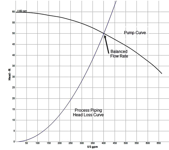

Since HVAC systems are recirculating systems, there is no static head for the pump to overcome. As a result, the pump simply needs to make up the head loss associated with the flow through the interconnecting pipelines and the air handlers. The head loss in a closed system can be simplified by graphing the head loss versus the flow rate (see Figure 1). By superimposing head loss curve on the pump curve, one can see how the system can work together. The flow rate through the system occurs at the intersection of the pump and head loss curves. By installing a VSD on the pump, the pump’s speed can be adjusted so the system flow rate can be matched to the flow rate required for the system heat load. Using this approach, the flow rate through the system can be controlled by adjusting the speed of the pump using the VSD. In chilled water systems, a design temperature drop is established for the heat exchangers in the air handlers. The flow rate through the air handlers is adjusted so the air outlet temperature of the air handler equals the temperature set on the occupied space thermostat. If the temperature of the occupied space is too high, the chilled water flow through the air handler is increased. When the temperature of the space is below the set value, the chilled water flow rate through the air handler is decreased. Now let’s see what happens when the thermal load of the space is only 50 percent of the designed heat load. Since the heat load of the space is only 50 percent of the design value, the chilled water flow rate through the air handler only needs to be 50 percent of what is needed. This causes the pump to operate back on the pump curve, resulting in greater discharge pressure. As a result, the differential pressure across the temperature control valves is higher at lower flow rates. In HVAC systems, with the large number of cooling circuits, air handlers and temperature control valves, the system must be designed to minimize pressure drop across the temperature control valves. This is why constant volume systems are still widely used in HVAC chilled water systems.Constant Flow Systems

Many building owners were looking at installing VSDs on chilled water pumps in existing systems. This is where problems started occurring. Looking at the simplified curve in Figure 1, the head loss in the system is represented as a single loss curve, which in reality consists of multiple loops working together. Each circuit is supplied by the common pump, but each path has head losses associated with the interconnecting pipelines, air handlers and a control valve. The outlet temperature of the air handler is adjusted by controlling the flow rate through the circuit.Figure 1. Head loss versus flow rate (Images courtesy of the author)
