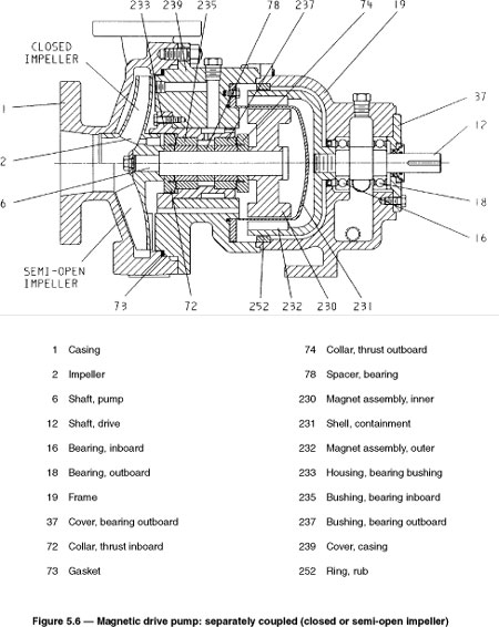

Q. We are considering using a magnetic drive pump for handling toxic liquids. The containment shell between the inner and outer magnet assemblies is very thin. We have concerns about wear in the shell and leakage of the liquid. Is our concern valid, and what can be done to protect against leakage?
A. Leakage of toxic liquid from any type of pump is a valid concern. You can take the following precautions regarding magnetic drive pumps:
The containment shell material must be selected to resist corrosion and erosion from the liquid being pumped. Metallic containment shells must be designed for the maximum allowable working pressure within the stress values for the materials in "Section VIII of the ASME Boiler and Vessel Code." There shall be a minimum ratio between bursting pressure and design pressure of 2 to 1 for the pressure/temperature range in the pump.
The gasket between the containment shell and the pump cover casing must be confined on the atmospheric side to prevent blowout. The design shall consider thermal cycling, which may occur as a condition of service.
Sensors should be provided to measure and monitor the position of the inner and outer magnet assemblies to prevent them from rubbing on the containment shell.
A secondary containment shell shall also be provided. This is usually done by the outer housing, which surrounds the outer magnet assembly, and a suitable sealing device around the input shaft on the pump side of the inboard bearing (Ref 16). See the figure below.
Provide a leak detector or pressure sensor at an appropriate location in the outer containment shell (frame- part 19-or cover, casing-part 239) to detect loss of primary containment.
For further information see ANSI/HI 5.1-5.6-2000 Sealless Centrifugal Pump.
