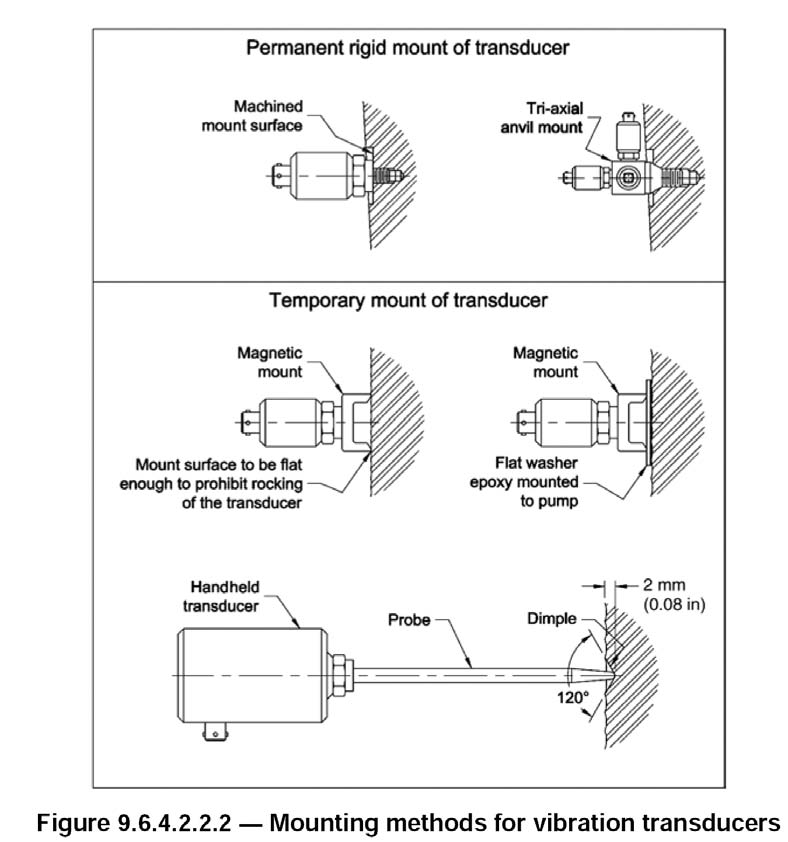

Q. What is the recommended instrumentation that should be used for measuring bearing housing vibration on rotodynamic pumps?
A.  For all speeds, a 6-decibel per octave filter shall be used to filter out frequencies outside the measurement range to reduce the electronic noise. This filter is typically built into dedicated vibration data collection instruments. However, this filter may not be present when using software processing alone.
For speeds above 600 rpm, the measurement instrumentation shall be capable of measuring the RMS vibration velocity in a minimum frequency range of 5 to 1,000 hertz.
For pumps with speeds of 600 rpm and below, the measurement instrumentation shall be capable of measuring RMS vibration velocity and RMS peak-to-peak displacement in a minimum frequency range of 2 to 1,000 hertz.
The manufacturer and the purchaser should agree on the type of data collector and the data collector settings for frequency range, frequency resolution, filter settings, the number of readings to average and any other instrument settings that may affect the measured vibration values.
Personnel who conduct vibration tests should take precautions to eliminate sources of errors in the measurements that may be caused by transducer mounting, transducer cable lengths, transducer orientation, magnetic fields, temperature variation and sound fields.
The vibration transducers should be mounted in such a way that they do not adversely affect the accuracy of the measurements. If magnetic vibration transducers are used, the surface of the measured equipment should be prepared in accordance with the transducer manufacturer’s instructions at the point of contact to avoid measurement errors.
Appropriate mounting methods are shown in Figure 9.6.4.2.2.2. More information pertaining to vibration measurements can be found in ANSI/HI 9.6.4, Rotodynamic (Centrifugal and Vertical) Pumps for Vibration Measurement and Allowable Values.

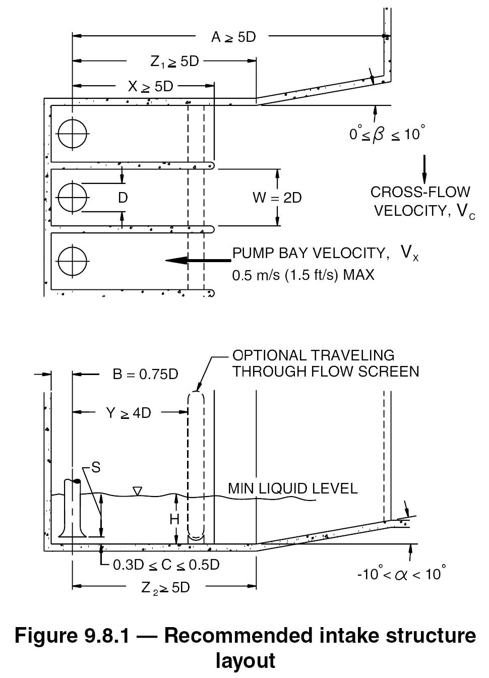

Q. What are some recommendations for dimensioning rectangular intake structures?
A.  The design requirements for satisfactory hydraulic performance of rectangular intake structures include:
Adequate depth of flow to limit the velocities in the pump bays and reduce the potential for the formulation of surface vortices
Adequate pump bay width to limit the maximum pump approach velocities to 0.5 meters per second but narrow and long enough to channel flow uniformly toward the pumps
The minimum submergence, S, required to prevent strong air core vortices is based in part on a dimensionless flow parameter, the Froude number, defined as:
 FD = V / (gD)0.5
The Froude number is a dimensionless quantity defined as a dimensionless grouping of parameters used in flow analysis and modeling that indicates the relative influence of inertial forces compared to gravitational forces. This equation is explained more thoroughly in ANSI/HI-9.8, Pump Intake Design.
The basic recommended layout for rectangular sumps, dimensioned in units of pump bell diameter “D,” is shown in Figure 9.8.1. The dimension variables and their recommended values as well as additional details are available in ANSI/HI 9.8.
