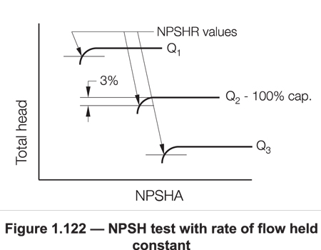

To determine the values of NPSHR, the pump is run at constant rate of flow and constant speed with the suction condition varied to produce cavitation. Plots of head shall be made for various NPSH values at a series of constant rates of flow (see Figure 1.122).
Figure 1.122. NPSH test with rate of flow held constant.
As NPSHA is reduced, a point is reached where the curves break away from a straight-line trend, indicating a condition under which the performance of the pump may be impaired. The 3 percent drop in head is the standard to determine NPSHR. Reference ANSI/HI 1.6 for more detail on this test
