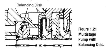

Q. Multistage rotodynamic (centrifugal) pumps usually have all impellers facing in the same direction. This causes a large axial force in one direction that requires a large thrust bearing to support it. What can be done to reduce the axial thrust?
A. One approach is to reverse the direction of half of the impellers. Assuming a six stage pump, the first three stage impellers would face in one direction and the next three stages would face in the opposite direction. To accomplish this, the flow from the third stage impeller is routed out of the pump and returned to the inlet of the fourth stage impeller. This adds the complication of the external flow passage, but reduces the need for a large thrust bearing. This design is often found in axial split multistage pumps.
Another approach is to add a balancing drum on the rotor, which counter balances the axial thrust. The drum is usually the same diameter as the impeller wearing ring and has full discharge pressure on the side by the impellers. Leakage through this drum clearance is piped back to the pump suction end. The result is low residual thrust that requires a much smaller thrust bearing.
In a similar design a balancing disc can be used instead of a drum. See Figure 1.21.
Multistage pump with balancing disc
In this design the balancing disc is larger than the impeller wearing ring diameter and the discharge pressure will push the rotor to the left. When that happens, the flow past the disc increases and the pressure at the disc is reduced by the increased loss through the close clearance bushing at the shaft. The result is a self-adjusting arrangement that requires little thrust bearing capability.
