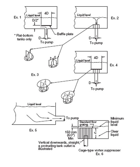

Q. Our pumps take their suction from an open tank. When the liquid level drops, surface vortices are formed that allow air to be drawn into the pumps. What changes can be made to the tank to correct this problem?
A. Undesirable flow conditions may be created at the pump inlet in the tank depending on the inflow-outflow arrangement in a storage tank, whether the tank inflow is operating while the pump suction (inlet) is operating, and whether flow obstructions exist in the tank. Even if only the pump inlet is operating and there are no flow obstructions in the tank, the non-uniform approach flow to the pump inlet may cause pre-swirl and vortices.
Since a dry-pit pump is usually located some distance downstream from its piping inlet in the tank, the effect of these flow disturbances on the pump is not as severe as with wet-pit pumps. For example, local flow separation, swirl or velocity non-uniformities, although creating greater head losses at the inlet, may be dissipated in the approach piping to the pump. The main problem is usually entrainment of air (or other tank gases) due to free-surface vortices, as this air may collect in the piping (causing air binding) or cause pump performance degradation.
Preventing the formation of free-surface vortices at tank inlets to pumps allows the tank to be drawn to lower levels than would otherwise be possible. This benefit requires the use of various anti-vortex devices at the inlet. Some common types of such devices are shown in Figure A.12.
Figure A.12. Anti-vortex devices

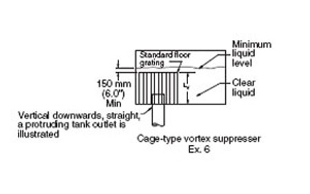

As an alternative, a cage type vortex suppressor may be used, as illustrated in Figure A.12, example 6.
Figure A.12. Example 6
The cubic cage may be made of standard 38 mm (1.5 in) deep (or deeper) floor grating (or its equivalent). The length, width and height of the cubic cage, each with a characteristic length termed Lv, should be about 3 inlet pipe diameters, and the top of the cage should be submerged about 150 mm (6 in) below the minimum liquid level. Non-cubic cage shapes are also effective if the upper (horizontal) grating is at least 3 inlet pipe diameters on each side and is also submerged 150 mm (6 in) below the minimum liquid level. A single horizontal grating meeting these guidelines may also be effective.
Tests on such cage type vortex suppressors have demonstrated their capability to reduce air entrainment to nearly zero even under adverse approach flow conditions (Padmanabhan, 1982). However, it may be noted that the minimum submergence from the tank floor is dictated by the vertical cage dimension plus the needed 150 mm (6 in) submergence above the top of the cage.
