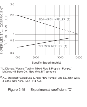

Q. Due to a recent thrust bearing failure in one of our deep well pumps, we would like to determine the down thrust on the bearing from the pump. Is there a simple way of calculating this?
A.  Following is a simplified version of this calculation, which is found in Hydraulic Institute Standard, ANSI/HI 2.3 Vertical Pump for Design and Application. This equation is for impellers with no back wearing ring and applies to operation at BEP only.
The approximate down thrust at BEP in pounds is calculated as follows:
Thrust = ( H x s x C x Adf x B)
                              2.31
Figure 2.45 provides the experimental coefficient “C,” which includes the impeller flow momentum change.  This coefficient was obtained from a number of tests on vertical pumps, with specific speeds from 1,700 to 12,000. The lines represent an average of these tests.  A pump manufacturer’s specific design may have a slightly different “C” value.

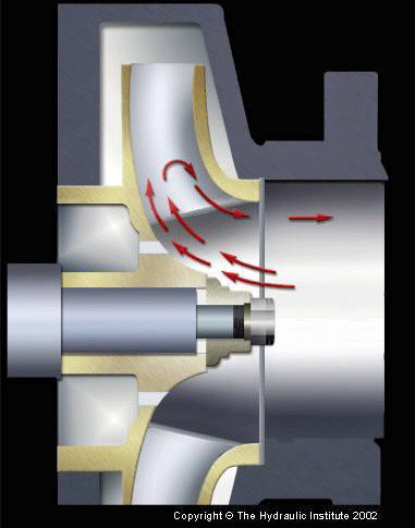

Q.  I keep hearing about suction recirculation but cannot find a good explanation. Can you help me?
A.  When centrifugal pumps are operated at rates of flow below their best efficiency point (BEP), the excess flow produced by the impeller is recirculated on the suction side of the impeller, as shown in Figure 5-12. These eddy currents cause local vortices on the impeller vanes, which in turn cause cavitation that results in noise, vibration, and damage to the impeller vanes.
Figure 5-12. Impeller showing suction recirculation.
This action usually begins between 70 percent and 50 percent of the BEP flow, and many pump manufacturers do not allow operation below the onset of recirculation. Furthermore, some impellers, which are designed for low NPSH Available applications, may begin the recirculation mode close to the BEP. An example of this might be condensate drain pumps in electric power plants.
