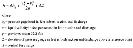

A. Before looking at the pump, check the measurement of total head and rate of flow. The proper equation for total head h is:
Many users ignore the change in velocity head and elevation head which often makes a significant difference in the total head. See ANSI/HI 1.6 Centrifugal Pump Test for extensive detail on this subject.

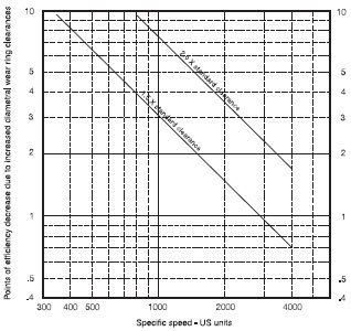

  • Pump wearing rings worn (see Figure 1.78B).

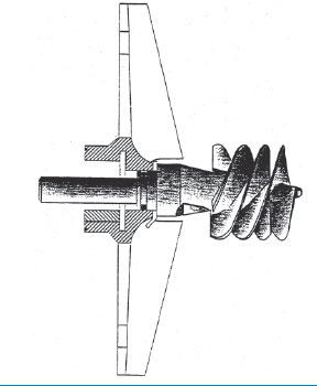

Q. What is an inducer and how does it work?
A.
Inducers are single stage axial flow helixes installed in the suction eye of centrifugal pump impellers to lower the NPSHR of the pump (see Figure 1.79). This allows use of increased rotating speed for a given NPSHA or a lower NPSHR for a given speed. Shallow blade inlet angles are used to draw liquid into the inducer channels, which are shaped to impart enough energy to provide sufficient NPSH for the main impellers to avoid detrimental cavitation.
Whereas centrifugal pump impellers often have a suction specific speed, S, of about 8000 to 12,000, use of inducers can increase S to a range of 15,000 to 35,000. This typically allows lower flow pumps to operate at 11,000-rpm with the same NPSH, which would be required at 3600-rpm without inducer, or reduce NPSHR of all pumps to less than half at the same speed.
Cavitation damage of inducer blades may occur above certain experience-established inducer tip speeds. At lower tip speeds, cavitation will not produce damage regardless of S value. Allowable tip speed is also a function of inducer materials; e.g., titanium alloy is 20 percent higher than for stainless steel. Tip speeds may also be increased for lower specific gravity liquids.
Inducer flow range must be designed and selected to provide sufficient S over the intended operating range to avoid cavitation in the main impeller. Suction specific speed typically is reduced at low and high ends of inducer performance range.
