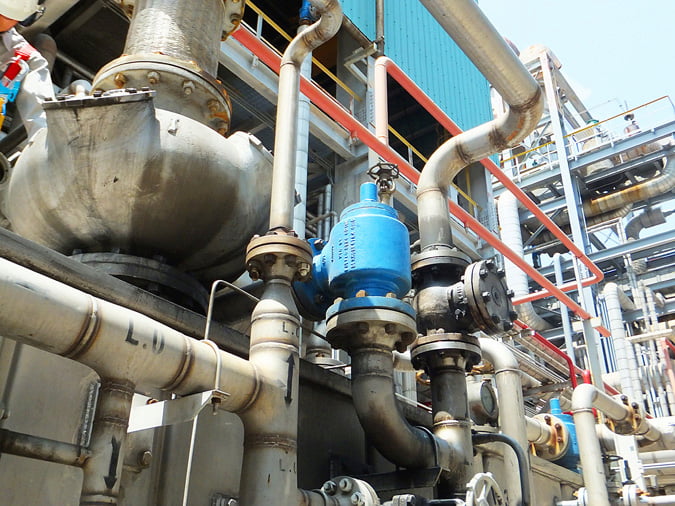

A pressure relief valve reduces strain on downstream equipment by mitigating this inevitable system pressure fluctuation. Guided piston valves are particularly suited to this type of pressure management. They reduce velocities through all but the controlling interface of the valve, thereby minimizing system power loss and even preventing system shutdown. The valves operate reliably at pressures as low as 3 pounds per square inch (psi) and as high as 1,000 psi and are, therefore, suited to a wide range of oil and gas equipment applications.
As a flow-modulating device, the pressure flow characteristics of a guided piston valve are different from spring loaded poppet or ball check valves. While a typical hydraulic valve has two operating settings—totally closed or fully open—a piston-guided valve fluctuates on a spring to maintain the set pressure. As pressure on the line increases, the valve opens a corresponding amount to maintain the set pressure. As pressure on the line decreases, the valve closes to the degree needed to maintain the set pressure. The valve returns to the closed position when the pressure on the line normalizes. Image 1 illustrates this self-modulating operation. The guided piston valve functions consistently and modulates at any degree of opening and closing. This operation does not require any external sensing or control systems for operation. The valve’s self-modulation is pressure actuated and self-powered. This modulation prevents pressure drops that might normally trigger low oil pressure alarms.

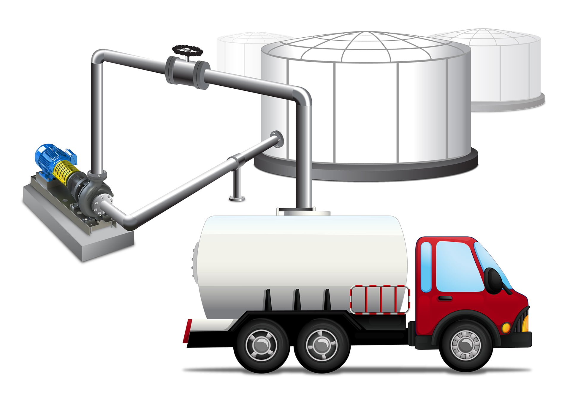

Use Case: Tanker Unloading
.jpg)
In Image 2, a typical truck loading process using either a centrifugal or positive displacement pump has a manual shutoff installed at the point of tanker loading. When the loading operation closes this valve without warning, considerable pressure builds in the line leading back to the pump, creating strain on the pump and risk for failure.
The solution is to add an external pressure relief valve to protect the pump and systems. The self-modulating guided piston valve is ideal for this type of installation as it requires no additional controls.
A new recycle line with a guided piston pressure relief valve is installed between the pump and the loading line. When the tanker truck is full and the loading valve is closed, the pressure back to the pump begins to build. The valve then activates automatically, diverting flow back to the tank and relieving pressure on the line to the pump.
When the next truck lines up and the valve is reopened, and the pressure on the line returns to normal, the pressure relief valve returns to the closed position automatically.
As this is a guided piston relief valve, the orientation of the valve does not impact the valve operation or set pressure. It can be mounted upright, sideways or even upside down—however space permits. This characteristic of the guided piston valve provides design flexibility in retrofitting problem processes.
