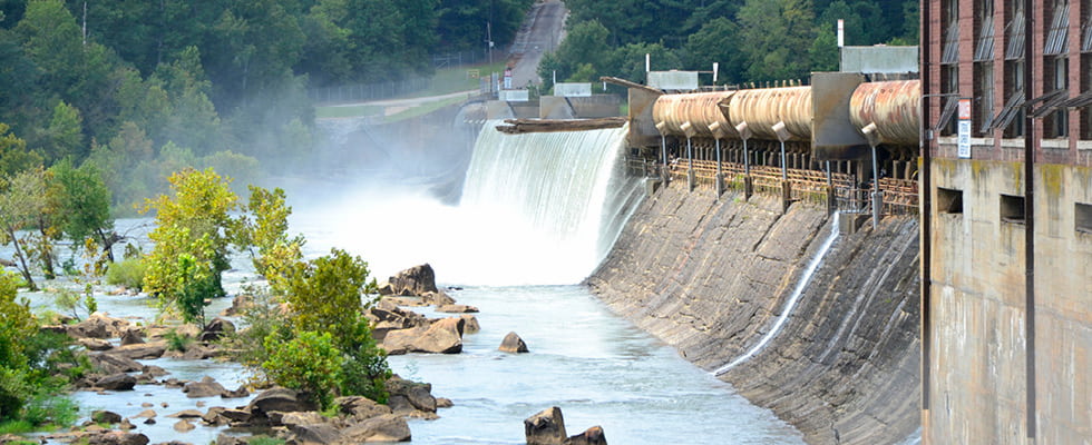

IMAGE 1: Water spilling over flood gates at a hydro in the southeast (Images courtesy of Jenkins Electric Company)
According to the National Weather Service, the highest recorded rainfall total from Helene was 30.78 inches in the North Carolina mountains. The multiple feet of rain that fell and ran down the mountainsides compounded into rivers that ended up nearly three stories over their banks. The French Broad River in Asheville, for instance, peaked at 24.67 feet over its banks, an all-time record (National Weather Service). The water in the rivers combined with mud, trees, furniture, vehicles, etc. to create a devastating battering ram headed toward the reservoirs and the hydroelectric dams that create them.
While all the dams themselves miraculously held up, the power plants were full of silt and debris and, in many cases, several feet of standing water. While this created an arduous cleanup job for the mechanical components (turbines, gates and piping), the generators and associated electrical switching and transmission equipment presented a much more significant challenge.

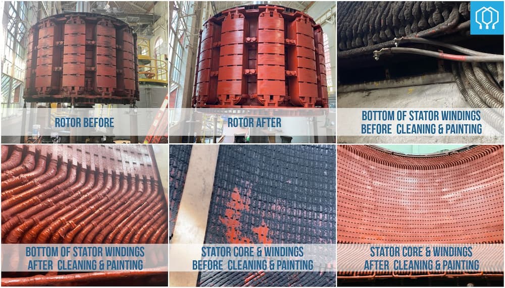

IMAGE 2: Before and after photos of dry ice blasting

3. Once all the necessary prep work has been completed, a flooded generator needs to be cleaned and dried as quickly as possible. Moisture and electricity are never a good combination, and gritty sediment can act as an abrasive that wears down the insulation between the turns of the winding as the generator spins.

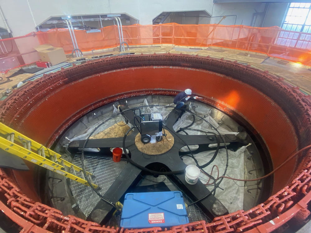

When working with a repair partner with experience in hydro generator repair, cleaning and testing, power producers can expect a team to be deployed to the affected hydroelectric plant to commence with dry-ice blasting and hand-cleaning the generators. Technicians should clean a portion of the stator windings to make sure insulation is not being damaged by the cleaning.
Older insulation tends to flake, and if that issue arises, it is recommended to resort to solvent cleaning instead of ice blasting (an electron dielectric solvent that is Environmental Protection Agency [EPA] approved is recommended).
IMAGE 3: Dry ice blasting of a hydroelectric generator stator
4. After close inspection of the windings for any visible damage, heating tents can be set up to fully dry out the units. Once the units are dry, a thorough electrical testing process should be performed prior to reinsulating and starting the units. Industry standard is to reinsulate the generator components with an ER41 red insulator to extend the insulating   properties and life of the generator components after cleaning.
