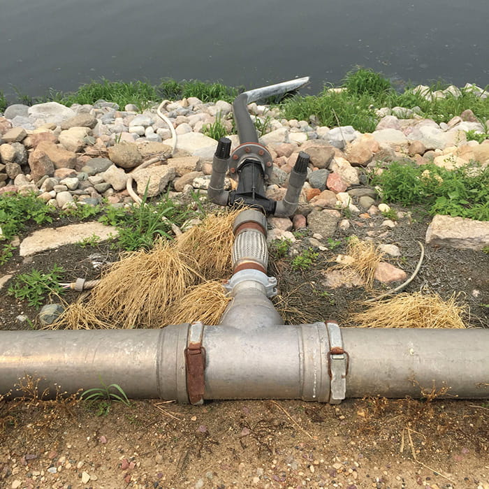

The manufacturer's specialized Venturi injector utilizes the physics of fluids with no moving parts. When pressurized water enters the injector inlet, it is constricted toward the injection chamber and changes into a high-velocity jet stream. The increase in velocity through the injection chamber results in a decrease in absolute pressure, creating a vacuum and enabling air to be drawn through the suction port and entrained into the water stream.![Image 1. Specialized injectors use the laws of physics to efficiently oxygenate water without any moving parts. The pressure differential between the water entering the injector and that of the water exiting the injector (pictured) draws air into the system, where it mixes with the stream. (Images and graphics courtesy of Mazzei Injector Company LLC)](/sites/default/files/0116/AirIntakes.jpg)

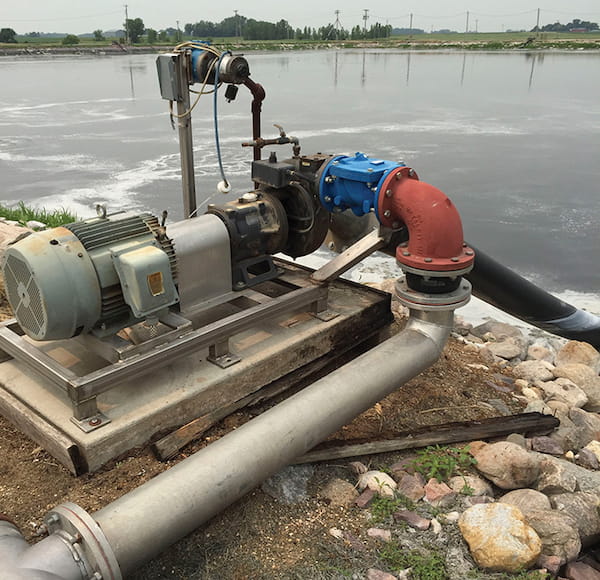

Designing an injector system for a wastewater lagoon is a team effort that taps the skills and experience of the end user, a local engineering firm, pump suppliers and the manufacturer's in-house engineering team.![Image 2. All pumps for this Venturi injector system are shore-mounted, making maintenance and repair convenient and safe. Pumps represent the only moving parts in the system, reducing energy demand.](/sites/default/files/0116/ConvenientPumpSkid.jpg)

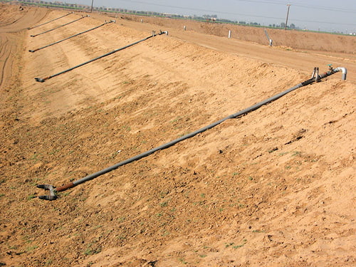

![Image 3. Because of their unique design, these mixing nozzles enhance gas/liquid mixing, gas transfer to the lagoon wastewater and circulation in the lagoon.](/sites/default/files/0116/InstallingNozzlesuse.jpg)

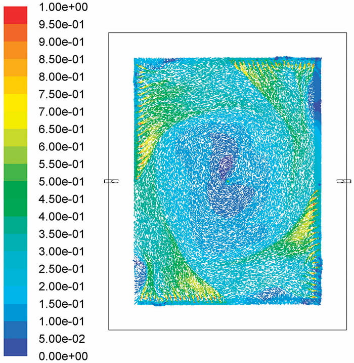

![Figure 1. Computational fluid dynamics help to optimize aeration system design for a lagoon's physical layout and wastewater composition.](/sites/default/files/0116/LagoonVectors-CFDuse.jpg)
