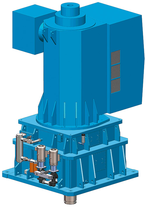

A vertically mounted, four-pole design, large horsepower AC motor sits on a planetary gear reducer.Figure 1. A vertically mounted, four-pole design, large horsepower AC motor sits on a planetary gear reducer.

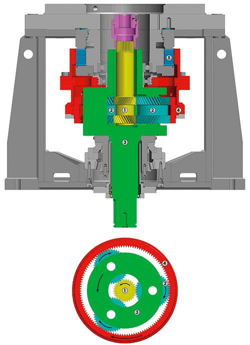

An alternative approach is a large horsepower, low-speed gear motor with a built-in hydro-viscous clutch. The controlled start transmission (CST) gear motor is manufactured in a fabricated steel housing that is designed to fit on an existing pump flange. The shafts and gears are made of high-alloy hardened and carburized steel to American Gear Manufacturers Association (AGMA) 2001 durability and strength. A vertically mounted, four-pole design, large horsepower alternating current (AC) motor sits on a planetary gear reducer (see Figure 1). By using a four-pole induction motor, the efficiency will be equal to or greater than a high-pole count design. The reducer is a single-stage reduction (3:1 to 9:1) CST with concentric input and output shafts for controlled starts and shutdowns. The reducer is flange-mounted to the motor with the male register for the driven equipment side, allowing for alignment to the pump. The planetary gearing shown in Figure 2 has four major components. The gears are double helical type for low noise and vibration. The sun gear (1) is the high-speed input to the gear box. Around the sun gear are three planetary gears (2) that are supported by the planet carrier (3), which is also connected to the low-speed output. The entire planet gear carrier assembly with the planet carrier rotates inside the ring gear (4). Speed control is accomplished through the clutch pack, which transmits torque between friction plates (5). This arrangement divides the power into three paths to reduce the load on individual gearing, affording high-power density and an efficiency in the range of 98.5 percent to 99 percent. The unit rating is based on the minimum rating of the components—such as the gears, shafts and keys.
Planetary gearingFigure 2. The planetary gearing
The planet cylindrical roller bearings are robust for the application with a minimum unadjusted design L-10 life of 50,000 hours at motor rating horsepower. Thrust loads are supported by a spherical roller thrust bearing with L-10 life of 100,000 at 36,000 pounds of external thrust. The drive is designed to accommodate momentary peak loads up to 200 percent. The unit is rated to a maximum design operating temperature limited to 200 F per AGMA 6023.
