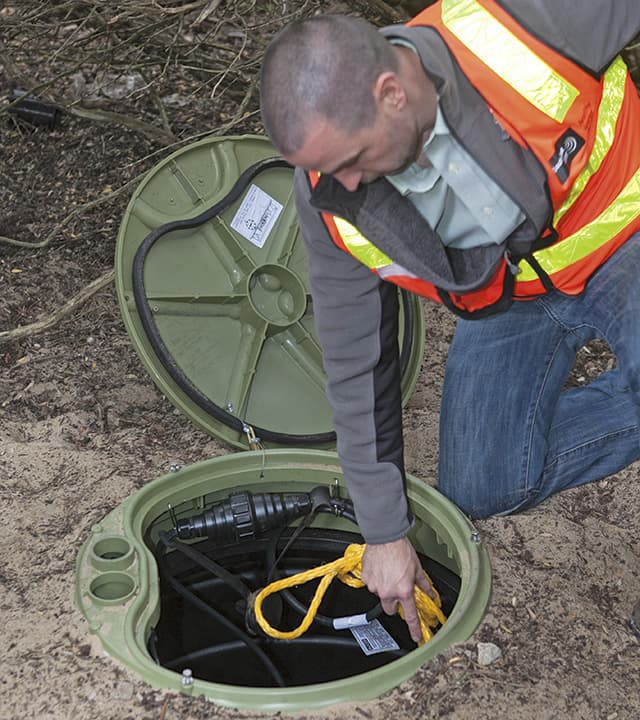

![Image 1. The E/One grinder pump station consists of a pump and holding tank. Pump, motor controls and level-sensing are integrated into a compact unit, easily removable for service. (Courtesy of Environment One Corporation)](/sites/default/files/0915/e-one_0048.jpg)

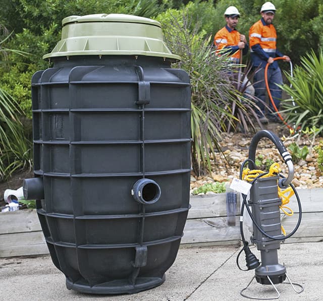

![Image 2. E/One's Derek Lachut providing in-depth installation training on-site (Courtesy of Environment One Corporation)](/sites/default/files/0915/e-one_0002.jpg)
