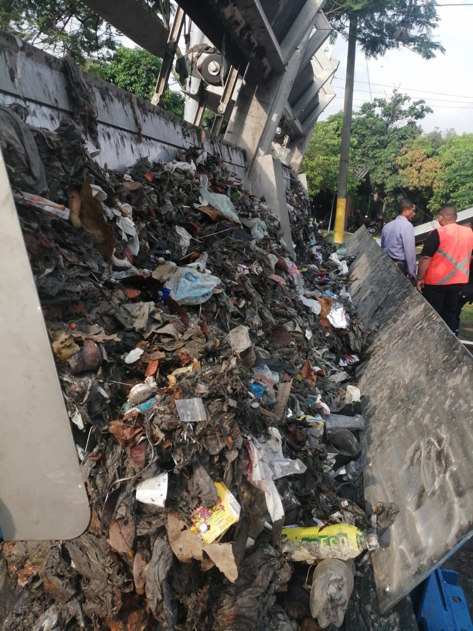

Plastic waste has become a major contaminant in Cali’s stormwater flow. Due to excessive rainfall, lightweight plastic is often carried over land and through the stormwater network to the treatment plants. At the Cañaveralejo and Floralia pumping stations, 30-year-old screens with 50-millimeter (mm) (approximately 2-inch) screen openings were allowing debris, especially single-use plastic bottles, to move into the channel, where they would clog and damage pumps, bioreactors, clarifiers and other equipment.
Stormwater is a top contributor of plastic pollution in waterways.
Because the 2-inch screen opening was allowing in so much plastic, plant operators sometimes had to suspend operations and physically enter the channel to remove bottles, rags and other contaminants. Access to the lower area of the previous grid for maintenance work was complicated because there was no way to divert the inlet flow, so personnel had to work at hazardous heights and in confined spaces.

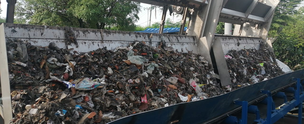

How Plastic & Other Debris Were Removed
The Cañaveralejo pumping station installed screening technology in December of 2022, and the Floralia pumping station followed suit in February of 2023. In Cañaveralejo, the old 50 mm (approximately 2-inch) screens were replaced by 12.5 mm (3/8-inch) screens. Due to much heavier flow, the Floralia screens were replaced by 25 mm (approximately 1-inch) screens.
Designed with patent-pending sequence technology, the new screens deliver exceptional debris removal. The scrapers have an enhanced tooth profile and unique collection geometry that effectively removes plastic bottles and other debris at higher speeds. Through flex/pivot action, the multifunctional link system eliminates underwater sprockets that are subject to jamming. Large debris is managed without shutdown, and scrapers return to cleaning the screen field faster.
