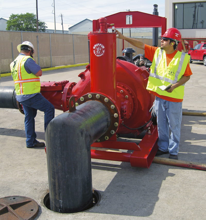

When selecting a trash pump, end users need to know the maximum fluid depth and consider the installation method because this will dictate what type pump can and cannot be used. Trash pumps come in two basic installation methods—above-ground or submersed. Typically, above-ground pumps are engine-driven or electrically driven, while submersible pumps are electrically or hydraulically driven. Either installation method will have advantages and limitations. For most applications, above-ground pump setups are preferred for ease of installation and access to the pump, which requires maintenance or may suffer a mechanical issue. An above-ground installation involves the pump placed near the fluid. A hose or pipe is connected to the suction side and placed into the fluid that must be moved. A hose is connected to the discharge of the pump to direct the fluid to the desired discharge location. Other than the pump, this setup requires minimal space on the suction side because the only item entering the fluid is a hose or pipe. While this setup is desirable, all pumps are bound by the laws of physics. If the fluid is below the pump, then all above-ground centrifugal pumps need a vacuum or need to create a vacuum at the pump, allowing atmospheric pressure to fill the void and push the fluid to the impeller. At sea level, the theoretical maximum suction lift for water of any above-ground pump under a perfect vacuum—regardless of whether it has a priming mechanism—is 33.9 feet. However, other factors limit the pump to a practical lift of substantially less—closer to 25 feet of suction lift with a maximum of approximately 28 feet. However, the volume greatly diminishes as the suction depth increases. Therefore, if the pumping level is approximately 25-feet deep, then submersible pumps should be installed because they do not have suction lift limits. Submersible pumps are placed into the fluid and push the fluid up onto the pump to a connected hose or pipe that carries the fluid to the discharge point. While a submersible setup is not limited to the pumping depth, it may create access issues since the setup is submersed. If the pump requires maintenance, it must be removed and replaced. Some submersible pumps have a maximum submergence depth (some as shallow as 50 feet or less below the fluid level), and special precautions are necessary to protect the pumps under these conditions. End users should check with the manufacturer’s recommendations when in doubt.Pump Types
An engine or electrically driven, above-ground trash pump is available in many types with different features. A self-priming trash pump is a specially constructed pump that will prime as long as its casing is initially filled with water. These pumps are generally easiest to use because they consist of a pump and its driver (electric motor, gasoline engine or diesel engine). The pump chamber is filled, and the pump is turned on. The impeller creates the vacuum necessary for priming and pumps the fluid out, once primed. Typically, self-priming pumps are used when priming time is not critical. The priming time is the time required from startup until the pump begins pumping by evacuating the air within the suction pipe or hose. The priming time depends on the suction lift but may take minutes with this type pump. A prime-assisted pump will prime under dry conditions, without water in it. Generally, prime-assisted pumps prime quicker than a self-priming pump. The priming time depends on the volume of air that needs to be evacuated, which is based on the size and length of the suction pipe/hose. Prime-assisted pumps consist of a pump, driver and priming device. The priming device may be a vacuum pump, diaphragm pump or compressor/venturi, which is installed with an air/water separation chamber with its float or priming valve. As the priming device’s air-handling capacity increases, so should the size of the air/water separator. In general, a vacuum-assisted pump will be the quickest priming pump because of the air-handling capability of the vacuum pumps. While they have the most moving parts, this type is a must for applications that require the continuous removal of large volumes of air—100 to 200 cubic feet per minute (cfm) and more—and in which priming time is critical. Typical vacuum pump types include rotary vane or liquid ring. If priming time is not as critical, the next quickest priming type is the diaphragm assist. Most diaphragm pumps will have a maximum air-handling capacity rating of 50 cfm per diaphragm. Additional diaphragm pumps could be added to increase the air-handling capacity. If the priming time is less critical, the compressor/venturi setup should be used because it generally has fewer moving parts and will likely cost less.
