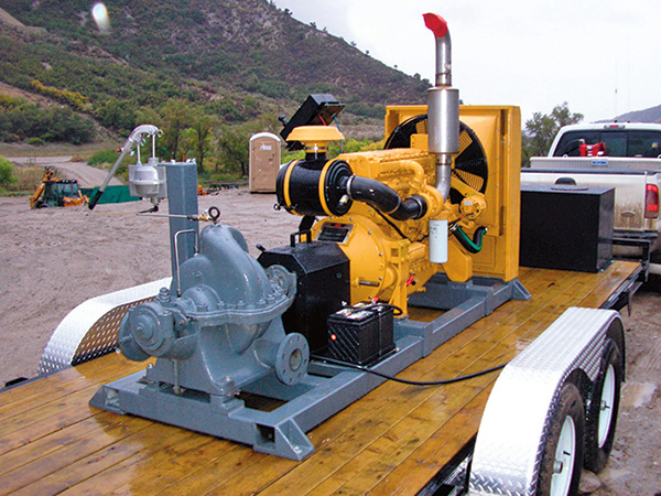

Figure 1
An example of an engine-driven packaged pump system

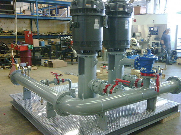

Figure 2
An example of a vertical pump skid that contains two large vertical pumps
