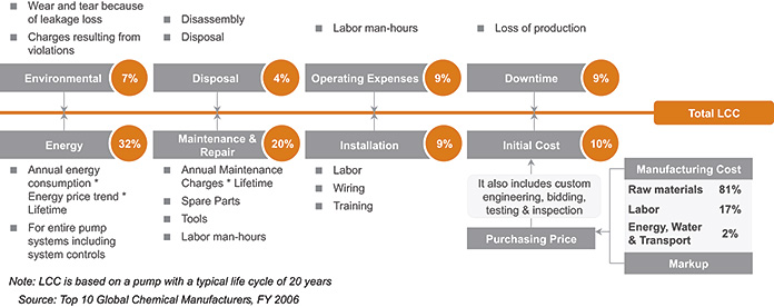

LCC is the total cost associated with an industrial pump from the point of procurement up to the point of decommissioning and disposal of the installed pumping system. It is an important tool to help plant managers choose between alternative resources and decide between repairs versus new purchase. Figure 1 shows the different costs incurred during the life of a pump, based on the assumption that the service life of the pump is 20 years. Of these eight major elements of LCC, energy, maintenance and repair account for approximately half the total LCC. These costs can be divided into the following three groups which are based on the buyer’s control over costs:
The costs incurred during the life of a pump.Figure 1. The costs incurred during the life of a pump.
  • Lower control comprises environmental and
disposal costs.
  • Moderate control comprises initial, operating and installation costs.
  • Higher control comprises energy, maintenance and repair, and downtime costs.

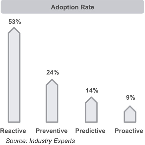

The adoption of different maintenance activitiesFigure 2. The adoption of different maintenance activities

Most pump users make procurement decisions based on the initial purchase cost which is often only 10 percent of the total LCC. LCC analysis provides the trade-off point between the initial purchase cost and the other cost elements that occur during the pump’s life. This assists in deciding whether to pay a higher initial cost to avoid unwanted and unexpected maintenance and other costs. Users have little control over many of the inevitable costs—such as environmental, disposal and installation costs. However, maintenance, energy and downtime costs can be managed, and potential cost-savings are associated with these factors.
Maintenance Cost Reduction Methods
Generally, pump users do not choose maintenance strategies based on the type of equipment. Reactive maintenance is not always the wrong maintenance strategy. Implementing predictive and proactive strategies on less critical pump systems may not be cost effective.

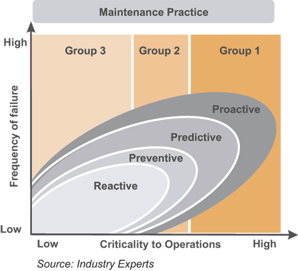

The adoption of maintenance practices based on criticality of equipmentFigure 3. The adoption of maintenance practices based on criticality of equipment
The group of industrial pumps in a plant can be segmented into three subgroups based on the pumps’ impact on plant productivity. Low-volume, high-critical and high-value equipment are in Group 1. Having proactive maintenance and predictive maintenance practices for this group makes more sense. Group 2 includes equipment that is moderate in terms of volume, criticality and value related to plant operation. For this group, using reactive maintenance practices at the cost of plant productivity is risky, but having a proactive maintenance is more costly. High-volume, low-critical and low-value equipment are placed in Group 3. For Group 3, having a more reactive maintenance approach is cost effective rather than other maintenance practices.

Energy cost accounts for a higher portion of the LCC of an industrial pump than any other cost. Buyers look for energy-efficient options to reduce the pump’s energy consumption. Table 1 shows the possible reasons for higher energy consumption and ways to mitigate them.

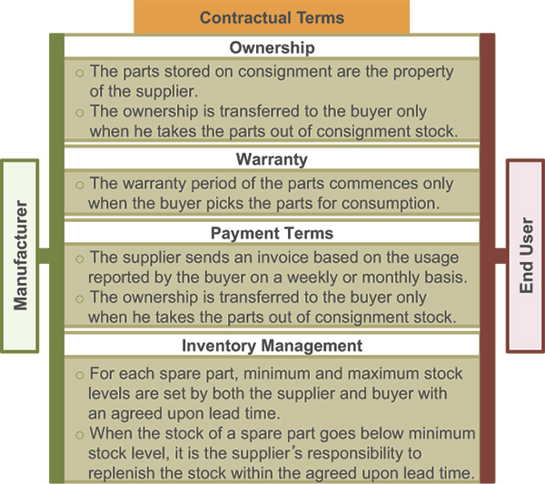

To reduce machinery downtime, all the spare parts required for operation-critical machinery need to be kept onsite. Usually, buyers purchase larger amounts of high-critical spare parts to prevent equipment downtime. As a result, they tend to pile up more spare part inventory when the demand for spare parts is fluctuating. As a result, the buyer pays higher inventory holding costs. For a pump original equipment manufacturer, 40 percent of its revenue comes from spare parts sales. To have a win-win situation for the buyer and the supplier, a consignment stock option is a preferred solution. Consignment stock is an inventory of spare parts that is stored at the buyer’s location but is still the property of the supplier. The buyer is required to pay for the parts only when he /she picks it up from the stock to use. Therefore, the buyer pays later, but the stock is readily available at his/her plant to reduce downtime. This type system benefits the buyer and supplier because the buyer has the spare parts onsite whenever the demand arises, and it is another avenue of profit for the supplier.
Consignment Stock Model
If end users are able to segregate the kind of spare parts to be kept at the consignment stock versus the supplier warehouse, they can save on the following:
  • Storage space
  • Premium to be paid
  • Insurance cost
Based on the nature of the spare parts—such as criticality and design—buyers are able to group the spare parts through formulated sourcing strategies such as:
  • Scenario 1—In the case of customized and high-critical spare parts, buyers should choose a consignment stock model with their supplier to keep parts onsite and available around the clock, which can reduce downtime.
  • Scenario 2—The critical but standard spare parts do not need to be kept onsite at all times because standard parts are easily available. In such scenarios, buyers can eventually save on insurance costs and inventory holding costs when they adopt a just-in-time sourcing practice. However, this depends on the proximity of the supplier to the production site.
  • Scenarios 3 & 4—When the spare parts are non-critical, buyers are advised to order standard spare parts when demand arises and non-standard parts based on their historical demand pattern.
Contractual terms and conditions—consignment stockFigure 4. Contractual terms and conditions—consignment stock
