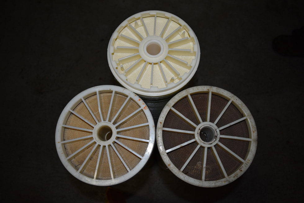

In many cases, membrane replacement can be surgical. In the case of permanent fouling, it is possible cleaning was ineffective with just the most severely fouled membranes, such as the inlet-end membranes, and only those will need replacement.

The polyamide thin-film membrane commonly used for reverse osmosis can tolerate many aggressive chemicals but has minimal tolerance to the presence of strong chemical oxidizing agents in its feed water—the most common concern being free chlorine. Even concentrations as low as 0.05 milligrams per liter (mg/L) of free chlorine will damage the membrane polymer over time. This oxidative damage is cumulative, as each exposure results in more breakage to its polymer links as chlorine atoms become attached within the polymer. An increasing normalized permeate flow rate, followed by a declining salt rejection, usually means membrane oxidation has occurred.
Ozone is another oxidant of concern if it gets into the RO feedwater. Even trace concentrations will rapidly react with the membrane. But while the inlet-end membranes will be quickly destroyed and require replacement, the ozone will be fully depleted before reaching the concentrate-end membranes.
Because free chlorine is less aggressive, its degradation of the RO membranes tends to be more uniform throughout the RO system, and all RO membranes will need to be replaced if the problem is not quickly corrected. Inlet-end membranes may be more prone to oxidation by a low concentration of free chlorine or chloramines if iron or other transition metals are in the inlet water, which tend to deposit in those membranes and will catalyze the oxidation.

Sodium bisulfite over-injection can result in a reduction in the dissolved oxygen concentration in the RO water, which then will cause the water to be more conducive to heavy growth of slime-producing bacterial species, which can quickly foul the RO system with stable biological materials that will be difficult to remove with chemical cleaning. Biological fouling is one of the most common fouling problems that can reduce membrane life. If the source of the biological materials is upstream of the RO, the inlet-end membrane elements will be most severely impacted and may require replacement.
