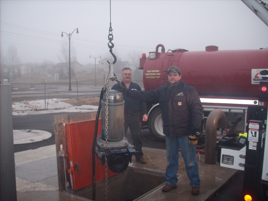

Doug Bode, maintenance supervisor, (background) with one of two 70-horsepower pumps pulled from the duplex station’s wetwell by a technician

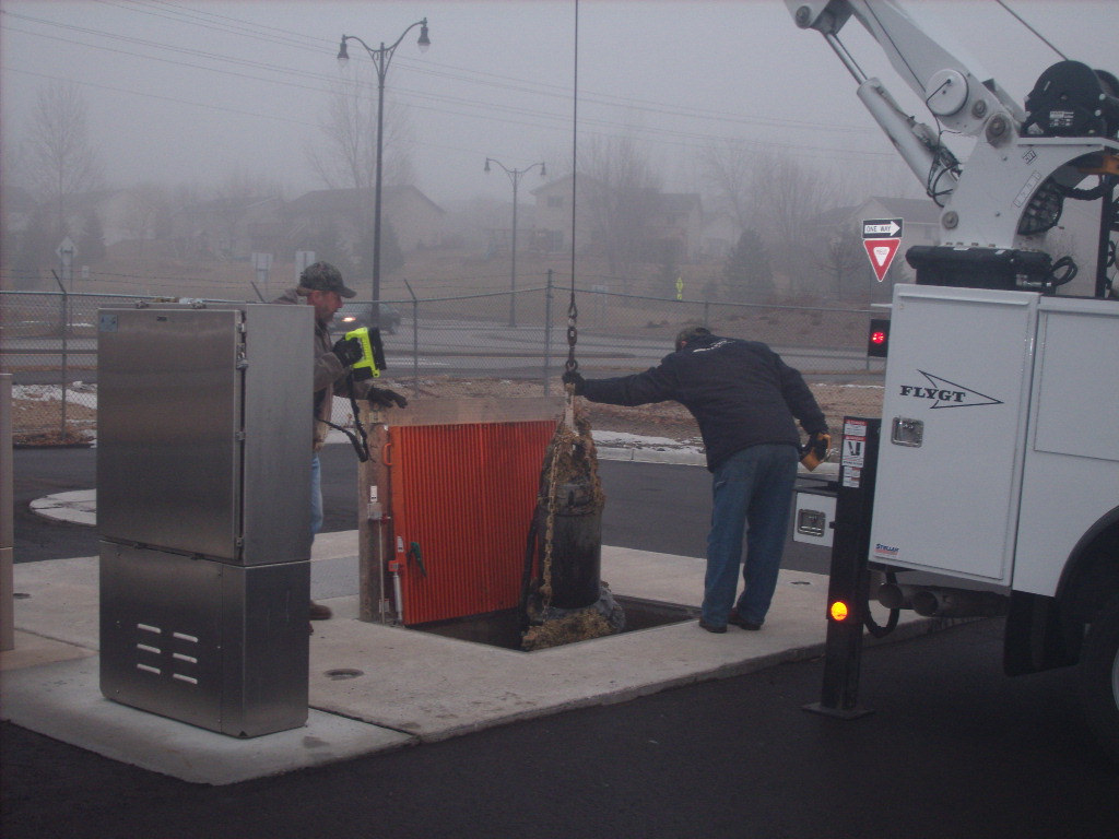

One of two 70-horsepower pumps being reset into the duplex station following inspection

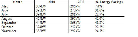

“The station has operated flawlessly ever since the Flygt N-pumps were installed, eliminating the clogging problem and noticeably reducing the station’s kilowatt-per-hour usage,” Bode added. “Several other stations have been equipped with the new pump and our future plans are to upgrade all 13 of our stations with the same type units.”
