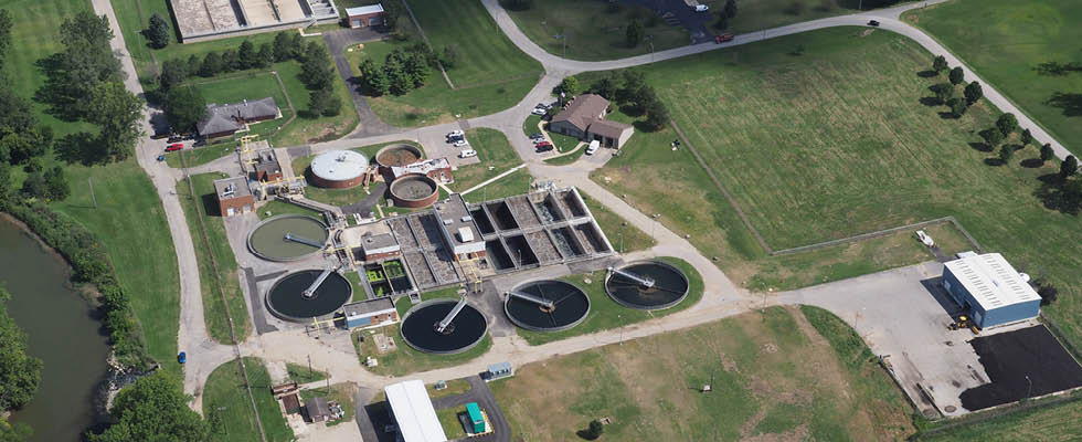

The wastewater treatment plant in Sidney, Ohio, expanded its capacity in 2015, replacing chlorination with UV and adding sidestream injection of air for post-treatment aeration.

As it increased the capacity of its wastewater treatment plant in 2015, the city of Sidney, Ohio, made two changes in operations. Its new design replaced the use of chlorine gas with an ultraviolet (UV) system for final disinfection and switched to sidestream injection rather than cascade aeration for post-treatment aeration. The new design simplified operations, nearly eliminating annual maintenance and fitting the aeration step into the plant’s existing footprint.
Sidney is home to about 20,000 residents, but its wastewater treatment plant handles a load equivalent to a city twice its size, with a large wastewater stream fed by one of Ohio’s largest per-capita industrial bases. In fact, industrial wastewater accounts for nearly half of the Sidney plant’s flow.
To meet the needs of residents and businesses, and protect water quality in the Great Miami River, the city expanded its wastewater treatment plant to a peak design capacity of nearly 14 million gallons per day (mgd). The plant’s discharge
permit requires treated wastewater contain at least 6 milligrams per liter (mg/L) of dissolved oxygen (DO) before release into the Great Miami River.

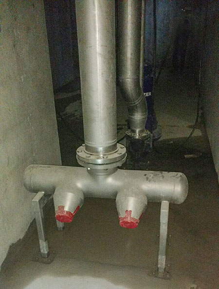

IMAGE 2: Basin nozzle manifolds, optimized with computational fluid dynamics (CFD) modeling, efficiently mix aerated sidestream water into the main flow.
IMAGE 1: Basin nozzle manifolds, optimized with computational fluid dynamics (CFD) modeling, efficiently mix aerated sidestream water into the main flow.

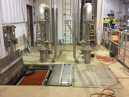

Design engineers worked with counterparts at an injector company to specify a venturi sidestream injection system for post-treatment aeration. The new design employs two, parallel sidestream recirculation lines, providing flexibility for turndown capability as well as redundancy. Each line pumps 1,000 gallons per minute (gpm) through a venturi injector, where the kinetic energy of the water passing through the constriction and expansion of the flow chamber is used to create a vacuum that draws in atmospheric air and mixes it thoroughly with the water. Each aerated sidestream is then reintroduced into the main flow in a contact basin through a basin nozzle manifold whose size and configuration were fine-tuned by the equipment manufacturer’s computational fluid dynamics (CFD) modeling team.

Because the injection system requires a sidestream of just 20% of the plant’s flow at peak capacity, it operates on a pair of modestly sized submersible pumps. Those pumps represent the only moving parts in the aeration system. As a result, annual maintenance of the sidestream injection lines is simply a matter of pulling up the pumps on their guide rails for a quick oiling and inspection.

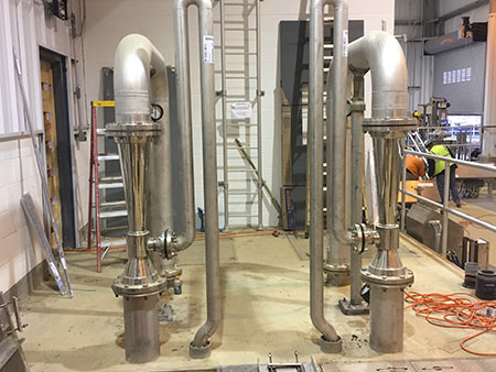

IMAGE 3: For the WWTP expansion, twin sidestream injection units fit easily within the plant’s original footprint, utilizing an existing contact basin.

The design team also realized the sidestream injection units could be installed directly above the plant’s original, small contact basin. Since the injectors were installed within the length/width dimensions of the basin, the oxygen transfer and thorough mixing achieved by the venturi injectors and basin nozzle manifolds requires much less space, lower depth and less contact time than fine bubble diffusion. In contrast, developing a fine bubble diffuser system for the expansion likely would have required the construction of a new, larger basin and an additional building to house the blowers supplying those diffusers.

IMAGE 4: Each of these venturi injectors use approximately 10% of the total plant flow to draw and mix air into the sidestream with minimal energy demand and no moving parts. The aerated sidestream is then mixed back into the main flow.
