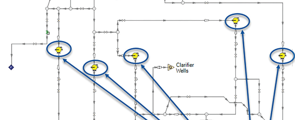

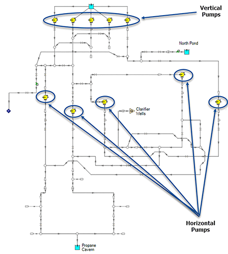

In this case, the pumping system was being used to deliver product from underground caverns and clarifier wells. Over the course of five years of operation, 41 repairs were required on the system costing over $1.23 million. A model of the pump system can be seen in Image 1. A consulting group was requested to perform a reliability study on the system and found the current pump configuration was causing the pumps in the system to compete hydraulically and to operate in the range of 30% to 50% of BEP.
IMAGE 1: Simplified flow model highlighting the locations of the five horizontal and five vertical pumps used in the system. Multiple cases were evaluated for the system by closing and opening different pump combinations.
Modeling different combinations of pumps allowed the consulting company to recommend an alternative method to operate the existing pumps in order to achieve the desired flow rate. The proposed combination allowed the operating pumps to achieve a flow rate at 75% of the BEP flow rate for each of the pumps.
