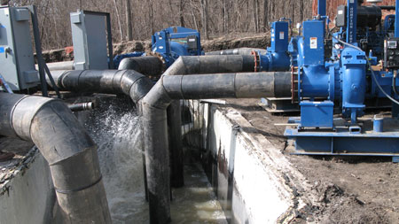

Three 16 in electric-driven self-priming primary pumps alongside four in diesel
Three 16 in electric-driven self-priming primary pumps alongside four in diesel drive backup sewage pumps perform in Sioux Falls, SD.
