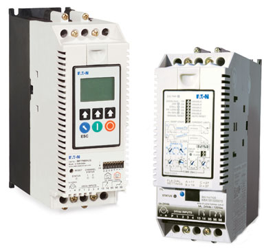

Soft starters and VFDs are useful for extending equipment life in HVAC applications.
New solutions are available that are specially designed to reduce or eliminate the potential for water hammer in a pump system, and they use an advanced starting and stopping algorithm developed exclusively for pump control applications. Soft starters can be effectively used to ramp up fans and blowers that are relied upon in HVAC applications. Additionally, variable frequency drives (VFD) can be used in applications that rely on variable speed control to harness energy savings.
Soft starter with pump control

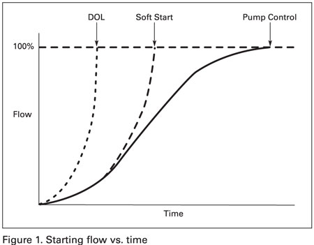

Soft Start Controllers With Pump Control
Figure 1 compares DOL starting, Solid State Reduced Voltage, and Pump Control starting speed flow vs. time curves. With pump control starting, the surge produced during DOL and Solid State Reduced Voltage can be greatly reduced by the use of advanced algorithm to carefully control the torque output to the motor. As there are no sudden changes in torque, motor acceleration is smooth, and surges and hammering in the system is minimized.
Comparison of DOL, SSRV and pump control characteristics

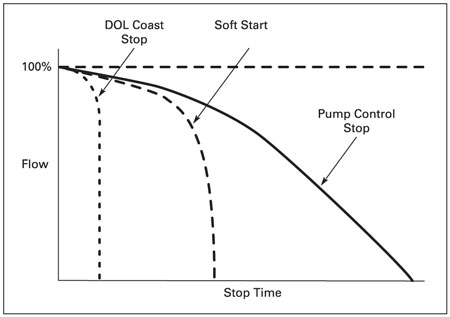

Soft Starter Controllers With Pump Control for Stopping Pump Motors
Stopping the pump is as critical to reducing surges and hammer as starting. In this discussion, examples will be limited to speed (flow) versus time, see Figure 2. When a DOL starter is applied, the pump motor will coast when a stop command is initiated (see DOL Coast Stop in Figure 2). The system head will quickly overcome the motor inertia and the pump will come to a rapid stop. The fluid, which is in motion and has momentum, must come to a complete halt as well. This action causes pressure surges on the pipes and valves, and can cause damage to the system.
In many applications soft stop cannot prevent sudden changes in motor torque required on pumping applications. When a soft stop is initiated, the voltage is ramped from full voltage to zero volts over a time selected by the user (see Soft Stop in Figure 2). Reductions in voltage result in reductions of torque, and the pump begins to slow down. However, a point is quickly reached where the load torque demand exceeds the motor torque supply and the motor stalls. The effect, though not as severe, is the same as slamming a valve closed, and hammering occurs.
There are soft start controllers that can control the deceleration of the pump motor in a method similar to the control of the acceleration. When a stop command is initiated, the controller reduces the motor speed to prevent any sudden changes in torque, minimizing surges in the system. The soft start controllers continue to reduce the torque of the pump motor, resulting in a speed characteristic as illustrated in Figure 2. This type of pump motor deceleration curve results in minimal surges or hammering in the system, as there will not be sudden changes in flow.
Comparison of DOL, SSRV and pump control stopping characteristics
Figure 2. Comparison of the DOL, SSRV and pump control stopping characteristics

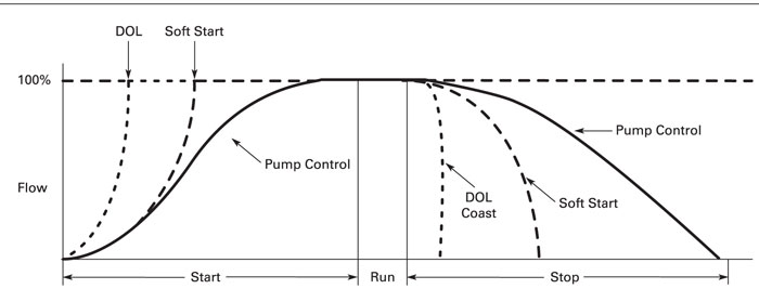

Soft Starter Controllers With Pump Control for Starting and Stopping Pump Motors
In summary, Figure 3 compares flow versus time when different starting/stopping techniques are used. The soft start controllers with pump control can produce the most desirable flow characteristics, when starting and stopping centrifugal pump motors. No sudden peaks or breaks in flow result in minimizing surges and water hammer in the system.
Figure 3. Comparison of the DOL, SSRV and pump control starting and stopping curves
