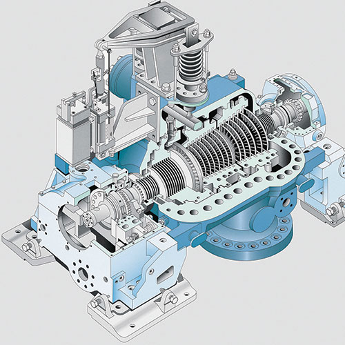

Many years ago, one of the popular drivers for a centrifugal pump was a steam turbine. Reliability, simplicity and operational convenience were primary factors in the pump driver selection before the increase in energy costs. During that time, a steam turbine—with its ability to operate over a wide speed range and speed match with a pump—was an ideal driver for a centrifugal pump. This choice is still common for large centrifugal pumps in some plants (petrochemical plants, refineries and boiler feed systems). Generally, standard, compact and reliable steam turbine designs (with reasonable cost) are available for use as mechanical drives.
Electric motor drives may require that a gear unit be used. Because fossil fuels can more efficiently be converted to electricity in large central power plants, electric motor drives began to displace steam turbines. Large electric motor drivers using a VSD are popular in plants. The initial cost may prevent the universal acceptance of VSDs for some small pumps. However, a VSD is the most common solution to increase efficiency (particularly at part-load operation) in medium and large pumps.

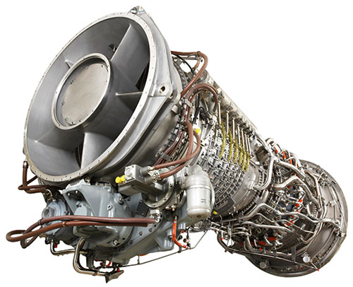

A gas turbine could be selected as large pump driver based on the available fuel and the specific requirements. Gas turbines are relatively standardized even though they cover a wide range of power and speed. They are not customized to a specific pump application for the power/speed match. Speeds of gas turbines are standard for a given frame/model. Sometimes, the output speed of a gas turbine can be considered when designing an efficient large pump train. If not, an intermediate gear unit will be needed. This adds the complication of another piece of equipment, a higher capital cost and potentially decreased reliability. This gear unit also has a high pitch line velocity. If exhaust heat recovery or regeneration is used, the efficiency of a gas turbine can be an attractive alternative.
Generally, drivers should be sized to continuously deliver no less than 110 percent of the maximum power required by a centrifugal pump. Sometimes, particularly with a gas turbine driver or critical train, this margin may be increased to 12 to 15 percent. Providing a suitable condition monitoring system and a combined control for both the driver and the pump is necessary.
